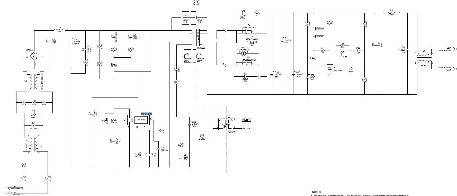

Submitted by doserme on 02/04/2015
We are having failures with a capacitor (C14) with a TOP250YN circuit from a big customer. I would like someone to look at the circuit schematic from your company and see if they have any suggestions. See attachment
Submitted by PI-KSAN on 02/06/2015
Thanks for Posting into forum. If you have failure Issues with a Big Customer, Please Contact our Local Sales Office or FAE near to you and report to him, so that we can resolve your issue,
PI-KSAN
