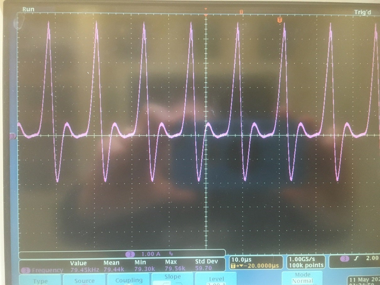

Hello.  I would like to report that the increased delay circuit did indeed work.  I reduced the size of the 10 uF cap to 1 uF to give a start up delay of about 1-2 sec.  Note this is not "slow start" but an actual delay of the start up on the final output.

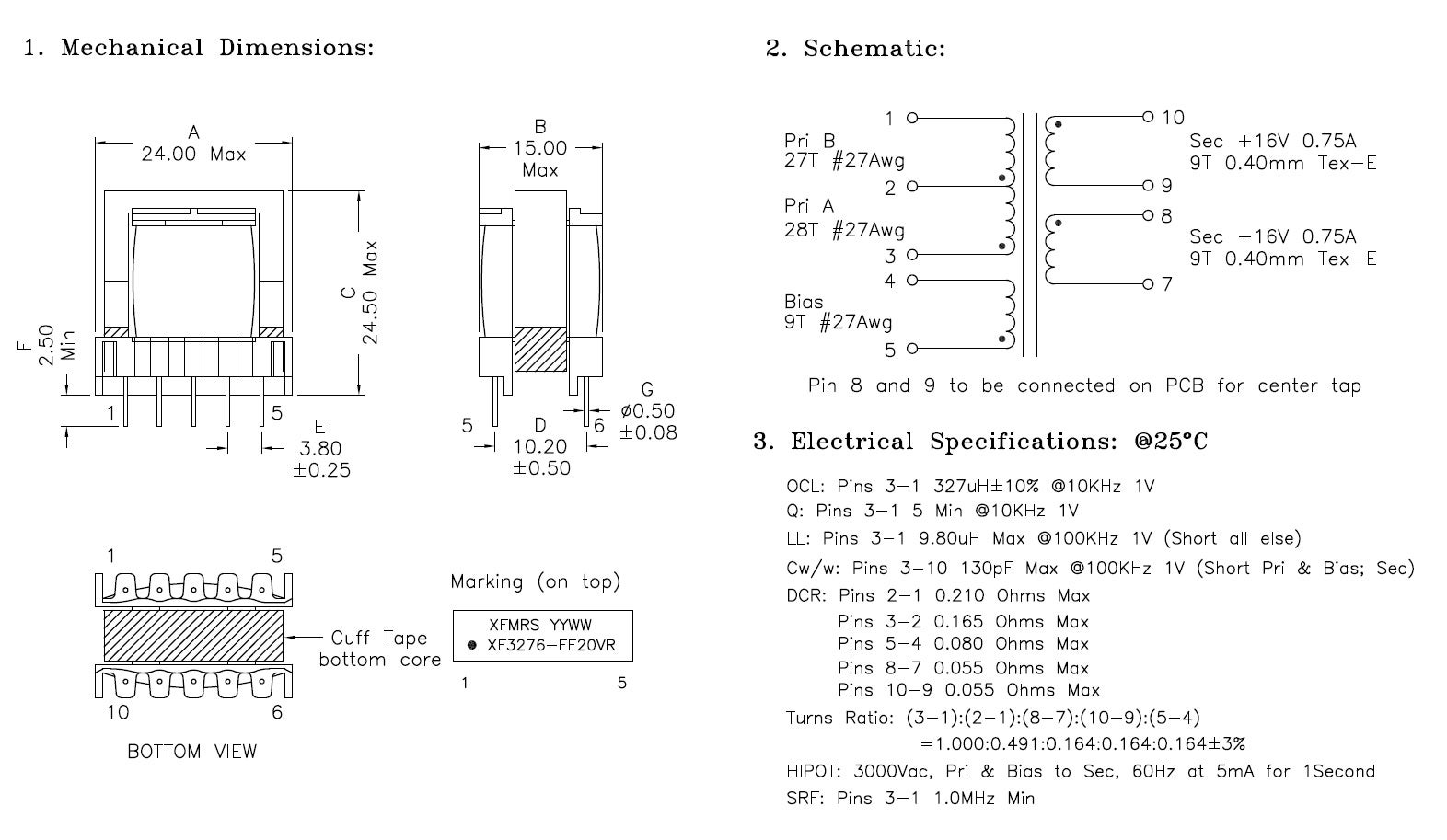

I do see a concern though with the amount of peak currents I see driving the load, which happens to be another switching supply (which converts to a high voltage). The 18 V output is switched in and out of the primary of the HV transformer through the FETs.  I would expect some ripple in the current, but not this distorted.  I am including screenshots of this and the same measurement made while powering the HVPS from a linear bench supply.  Some ripple is there, understandably, but not as bad.  I am concerned the ripple current in the output capacitors is extreme, especially with current spikes going negative.  Is there something I can try to reduce the amount of spiking in the current?  I've also attached a sketch of the transformer design.  Schematics, layout etc already attached in earlier post.  thanks!
