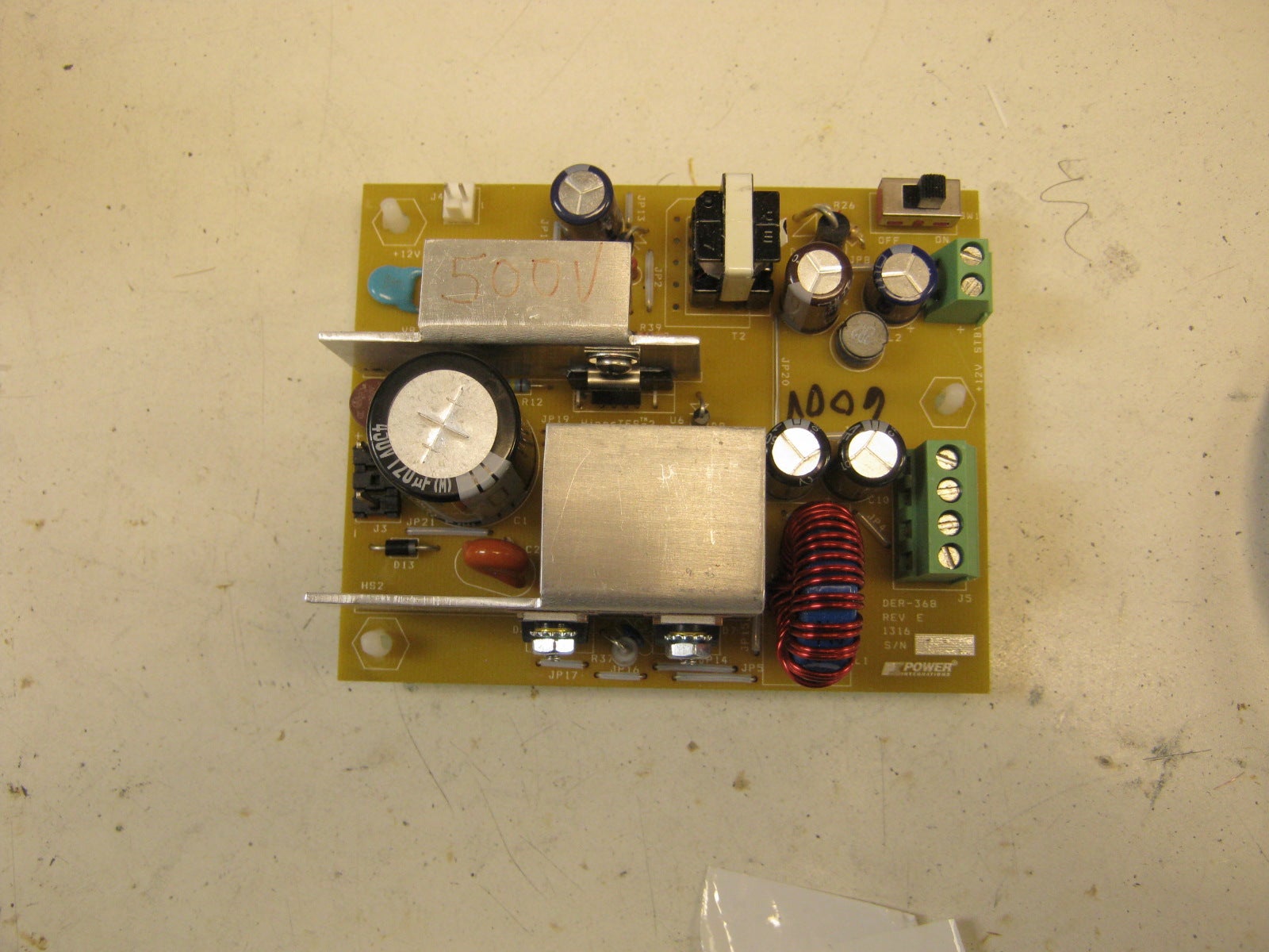

Another approach that might be fruitful for your application would be to use a forward converter instead of a flyback. This would result in much lower peak currents in both the primary and the secondary, reducing heat sinking requirements. Stress on the output filter capacitors would also be greatly reduced,. and the transformer is also much smaller.
Attached is a photo of one of our eval boards, the DER-368. This is a 150W, 12V 2-switch forward DC-DC converter using the TFS-2 series of devices from PI, running at 132 kHz. We use a proprietary scheme to allow duty cycle of >50% for a 2-switch forward converter. The TFS-2 also incorporates a standby controller w/mosfet that could be used to generate your supervisory supply. The eval board is currently configured to accept a 380V DC supply, but it could be modified for use with rectified and filtered 180-264VAC. This would probably require the next size larger TFS device to reduce heat loading. The eval circuit currently uses schottky rectifiers rectifiers at the output, but the forward rectifier could be replaced with a self-driven synchronous rectifier for greater efficiency and less power dissipation. This is described in the report for eval board DER-428.

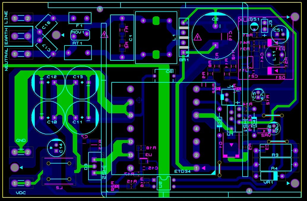

It would be a good idea to post your circuit (at least the high power portion) so I can see what is going on. It would also be a good idea to add a damping resistor in series with the primary snubber diode to help reduce the stress on the snubber diode, which may be forced to recover several times in succession as the leakage inductance discharges and the snubber circuit rings, causing excess power dissipation in the snubber diode. I would try a starting value of ~10 ohms to start for the damping resistor. It may be also necessary to go to a 3A snubber diode at your output power level.
For a high power application such as yours it is necessary to minimize the loop area in both your primary ans secondary circuits, as a loose secondary layout acts the same as high transformer leakage and will result in more stress on your snubber. It is also important to minimize the transformer leakage inductance for the same reason. A picture of the Topswitch drain voltage and current would help provide guidance.

I have attached the circuit diagram and the board layout.
Please suggest any other changes too if necessary.

Both the primary and secondary sections of the board have large loop areas, adding to the effective leakage inductance. If you cannot move the primary bulk capacitor closer to the snubber and TOPSwitch, I suggest adding a 100nF capacitor as a bypass to provide a shorter path for high frequency currents. The layout on the secondary side needs to be considerably tightened up to reduce the loop area and stray inductance, which adds to the effective leakage inductance that must be handled by the primary snubber. One way of doing this would be to use organic polymer capacitors instead of standard electrolytic capacitors. They have higher ripple current ratings and lower ESR for a smaller size, allowing a more compact layout. A tight secondary layout is always important for flyback converters, but even more so for higher power designs that experience higher dI/dt on the secondary side.
The schematic still shows universal input and only a 68 uF bulk capacitor.

We haven't been able to do much to reduce primary loop areas due to tight dimensions and board layout constrictions.
Regarding secondary section, is there any other way to reduce the loop area with 4 capacitors at the output side. Will removing solder resist from the tracks help in some manner?
I have uploaded new PCB with ES3J, removal of solder resist at some points(with the aim to reduce resistance and act as heat sinks) and an even larger heat sink. Please suggest any changes. Is the 100nF Capacitor (C19) to be added parallel to bulk capacitor C2?

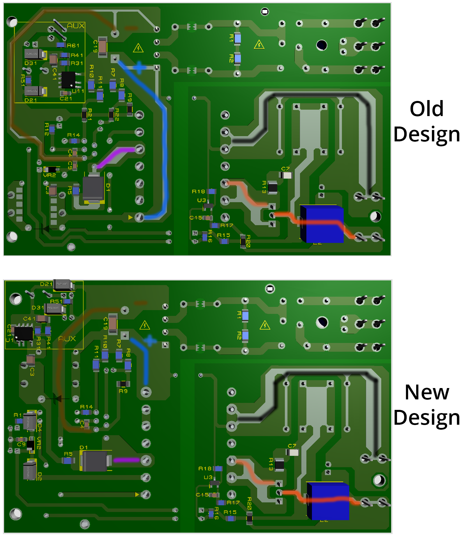

We have updated the design and tested the prototype.
I mirrored the transformer pin-outs and reorganized the components to reduce the distance.

Please have a look at the new loop area and suggest improvements if any.
Submitted by PI-Wrench on 12/03/2020
The new layout shown looks precisely the same as the original shown in post #14, at least from the top side view.
I still suspect that the polarity is wrong on the bias winding. The bias rectifier anode should go negative during the TOPSwitch "on" time. If the polarity is wrong, the bias rectifier will experience high peak current when the TOPSwitch turns on, as it will be trying to directly charge the bias filter cap. This can cause the bias diode to thermally run away. Sometimes this will also cause the supply to prematurely shut down.You should be able to see the bias winding polarity with an oscilloscope, even with the probes you have. Also, a tell-tale sign that the bias winding polarity is wrong is that the bias voltage will track the input voltage rather than remaining relatively constant. This should be examined at a relatively low and constant output current, as the bias voltage can also vary with output current.
The clamp design is complicated by a poor layout, as the excessive stray inductance can cause the clamp diode to recover several times in rapid succession when the clamp engages, causing excessive dissipation in the clamp diode. Improving the primary snubber layout and adding a series damping resistor to the clamp diode will both help address this issue. A 3A rated clamp diode also wouldn't hurt.

I have attached the uds file for the new design
I have also attached the PCB comparison highlighting the change in loop area and Transformer Pin-out comparison of both old and new design. Please give your opinion.
The supply is operating as intended but at higher loads the clamping resistor R5(series damping resistor) fails open, shutting down the supply.

The bias winding is connected as given in PIExpert suite. Pin1 to Source and Pin2 to Rectifier(D2) in new design.
The TVS diode has been marked on Comparison1.png and it was getting really hot during operation. But since it has been placed away from clamp diode in new design the clamp diode is comparatively cooler.

The primary layout is improved, but the secondary layout is still fairly loose, looking the same as your previous layout. Again, I suggest using aluminum polymer capacitors in you secondary filter, as they can be more compact than conventional electrolytics, with enhanced ripple current rating, and will result in a more compact secondary layout.
Stray inductance on the secondary side acts just like excessive leakage inductance, putting an extra burden on the primary clamp, and also causing spikes and ringing on the secondary rectifier that may give rise to HF EMI problems.
Regarding the damping resistor for the primary clamp, with a supply of this power level, I use two 1206 resistors (in series or parallel) for extra power dissipation capability. If you now have your 100X probes, you can monitor the drain voltage and optimize the value of damping resistor to reduce ringing on the drain waveform after the leakage inductance discharges. The goal is to keep the clamp diode from repeatedly recovering each cycle, which will result in extra power dissipation in the clamp diode. You may be using more damping resistance than is optimal.
Reducing the value of your primary clamp resistor will help reduce the power dissipation in your clamp TVS, though the resistor will get hotter as a result. The other factor that can cause the clamp TVS to overheat is using a value that's too close to your transformer's reflected voltage. What value of VOR did you use in your design? It may be possible to increase the TVS clamping voltage to reduce heating, while still protecting the primary switch against excessive voltage.
