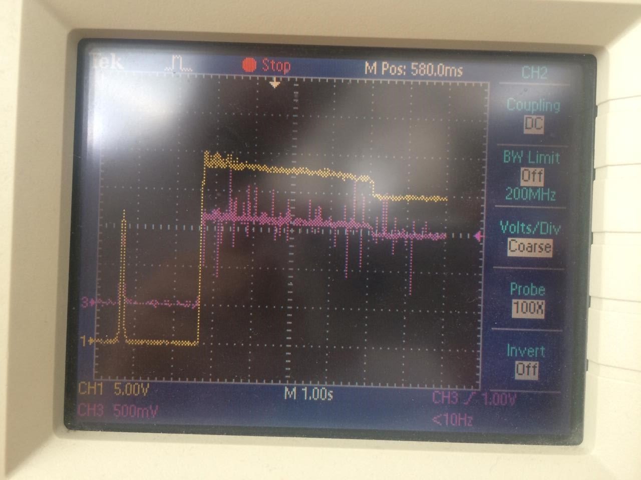

As for the secondary side, the following happens there, I attach a graph from an oscilloscope (yellow graph-VOUT, purple-FB). The tripping moment occurs when the voltage on the FB contact reaches 1.22 V, and the output voltage rises to 24 V, and this with the same rectified input voltage. The graph shows off time. I have a 24V output, I think the zener diode in my case is not needed to protect the VOUT contact.Sorry for my English.

Hi Ensider,
Could you plot the waveform at 5seconds/div?
I observed on the waveforms, that the auto-restart OFF time is about 2seconds so it the fault is on the primary side.
It could be that the primary OVP circuit triggers or the Line OV protection. Try increasing the V-pin resistors (R44 & R47) to 4M-ohm or trim the resistance (R40) of the primary OVP circuit.

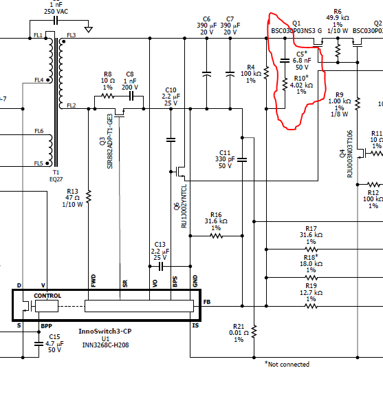

This is my current limiting line. Circled in red. Current limitation calculations.

Hi Ensider,
Could you try connecting your current sense resistor to ground of C47? That's where the load current will flow.
