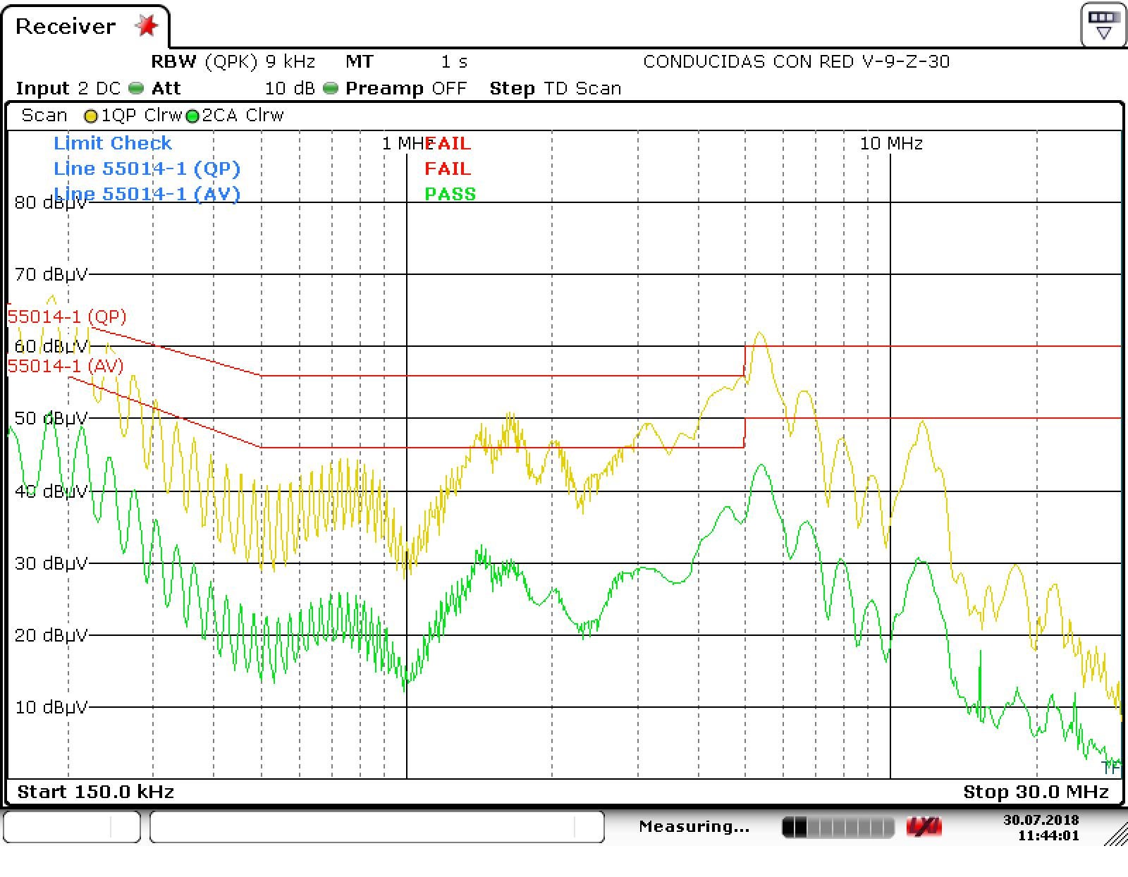

I have a power supply based on the TOP269EG with the an output of 24V @ 5A (max) and the input range from 190 ~ 260Vac.
This power supply was developed and designed according to the technical data (and datasheet) of the TOP269.. for now it works OK.. but it fails in the certification process, in this case in the norm: EN-55014
In attachments I send the scheme details and also the PCB drawing, and the result..any idea for this bad EMC performance? Is there anything that we have made incorrectly. In the results you can see the noise at at 150Khz and at 20Mhz... is there anything we can do to reduce it?

Thank you for using PI product on your design. You can try the following and check if it improves the conducted EMI:
1. Increase the total value of C91, C93, C94. Right now the total capacitance is 530nF. You may try to increase it to more than 750nF. But be careful with the safety certification for discharge. You may need to change also the R1 and R2 discharge resistors. You can also try to check our CapZero product for improve efficiency for this discharge resistors.
2. Can you try putting a shield in between the heatsink and T2. You may try to put a thin metal sheet in between to check if this is the cause of higher EMI.
3. You can try to add a differential choke in series to F line.
4. You can try to ground the core of the transformer. Put a tin wire on the core (i.e the conductive wire touches the core surface), then terminate it to either the GND or DC_Bus.
5. This can be difficult but looking into your layout, it seems there's a big loop going from DC_Bus to + of transformer then to the drain of the IC, then Source of the IC to C3 ground then to negative of the bridge. This loop area generates noise and it can creep going to the line which may result to higher EMI. If possible always make this loop as small as possible.

Hi SevenofNine,
I have made all the suggestions you have said (not the item #4). The results are a little bit better but it continues to fail. In attachment I send the new documents.
Any feedback?
with no load -> Stanby (238.13 KB) 238.13 KB
with normal load (247.29 KB) 247.29 KB
max load (263.4 KB) 263.4 KB

Submitted by PI-SevenOfNine on 07/31/2018
Hi ralph79,
After checking your circuit again, it seems that the snubbing circuit were not optimized. The diode (D1) used for the primary snubber circuit should be a slow diode. You can try to use FR107 for this. The snubbing circuit were also using very large values of capacitor (C64 & C63) as well as the discharge resistor of 47K in parallel. You may refer to the snubber circuit of similar design on below link.
https://ac-dc.power.com/design-support/reference-designs/design-examples/der-580-118-w-high-line-input-non-pfc-cv-cc/
Please also modify the snubber RC on the secondary circuit (R21 and C66). Please changed it to 220pF and 68ohms.
Please also change bias diode (D3) to US1D. You do not need a schottky diode here.
Hopefully it helps.
