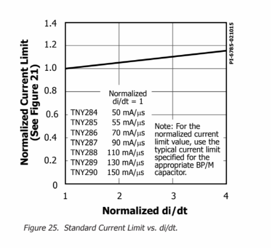

I found in TinySwitch-4 family datasheet a curve providing the current limit variation, considering normalized values (file attached). Is there anything like this for the LinkSwitch-HP family?

Submitted by PI-Jedidiah on 03/08/2018
Hi Daniel,
We don't have graph of normalized current limit versus normalized di/dt on linkswitch-hp.
What specific application do you need? Power supply is designed based on the maximum power requirement of customers. The maximum di/dt is used to calculate the design needed.
