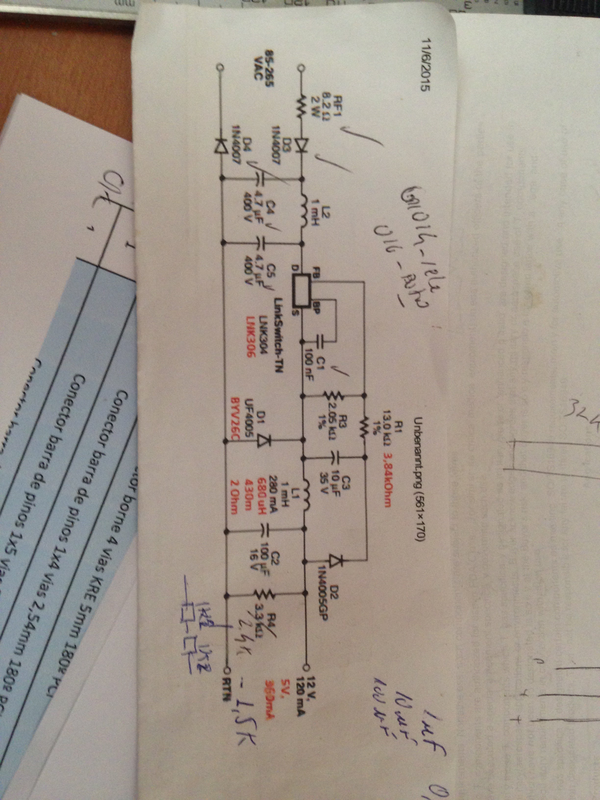

I assembled in a breadboard a circuit that theoracly should provide at least 350mA at 5.0V. But when the current achieve 150ma, start a crazy behavior, the current and voltage goes down an up... and not stabilize anymore.
I`m using LNK306, R1 3,9K, R3 2K, L1 680uH (681), D1 BYV26C, D2 UFN4007.. and all other components as the design reference.
What I did wrong? Some idea of the reason for the current is being limited to 150ma?

Could you please send us the schematic of your power supply, your PIXls/PIExpert design file.
Do you know if the inductor is getting saturated that you are using.
What is the saturation current of the inductor that you are using?

Schematic attached.
I don´t beleive the inductoris getting saturated with that current... less 200ma,
The inductor I´m using should have a 1.3A current saturation

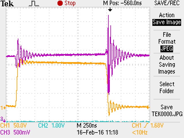

Hello Again. Now, my PS is working in one of the PCB, with all componentes (I have to check the others two). but If a take a look closer with the osciloscope, I can see the voltage is rising up to 4.82V and falling until 2,06 for small period of time. This is normal?
I attatched screen from my oscilloscope with two differentes times. With a multitester , the average voltage is about 3,4 Volts. I changed the  rfb resistors for a 2K resistor.
Byt the way. in the graphics, I am measuring the cathode of DFB diode (yellow) and the output (purple)
Do you have your PIxls design file? How did you come up with the value of 680uH? is there any calculation?

From the waveforms I could see that there is lot noise pickup from the probe. How are you probing the output voltage?
You have to use a close coupled probe or barrel probe to minimise external noise pickup.
