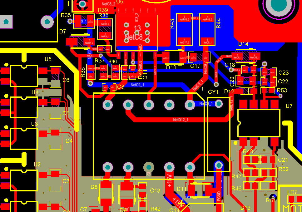

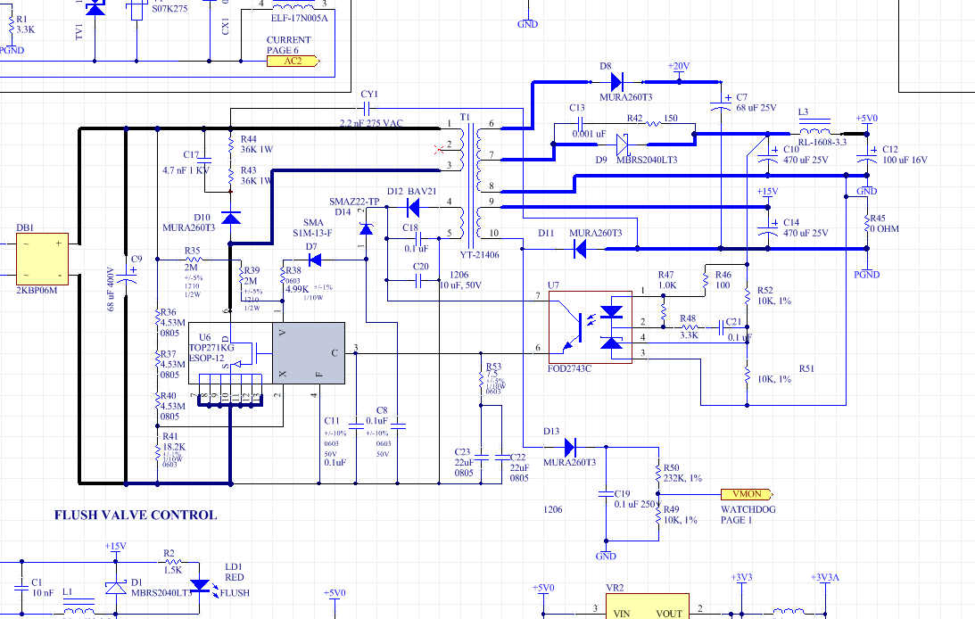

Hi -
I have your IC in about a 30 watt supply putting out 5 & 20Vdc.
There is a stability problem when adding the overvoltage zener, otherwise it acts fine.
I am including a bit map schematic and layout to help your diagnosis.
You may contact me at tom.dawson@siliconengines.net or by phone at 224-795-5372. Please email me if you can because I am harder to reach by phone. Are there problems with C22, C23, C20 being ceramic, or is there any problem with the layout? this is a 2 layer pcb.

Submitted by PI-KSAN on 02/25/2015
Thanks for Posting your question, Could you please explain at what load you are seeing stability problem. Do you have output voltage oscillations, I really like to understand at what line and load condition your seeing output stability? Please explain us clearly.
