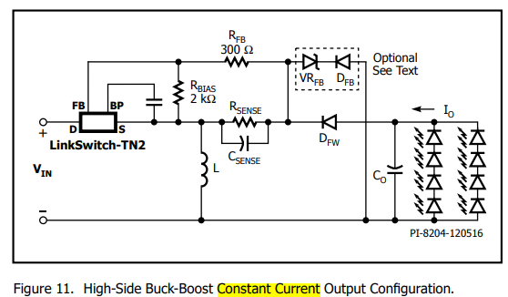

Submitted by PI-Nanoe on 06/19/2025
Hi Dhruvit,
I would recommend checking our LinkSwitch-TN2. Unfortunately, we do not have existing design for TN2 that implements constant-current.
However, we do have design guide, which help you design our LinkSwitch-TN2 in a constant current implementation for LED application, please see figure 11, page 13 of AN-70 design guide.
PI-Nanoe
