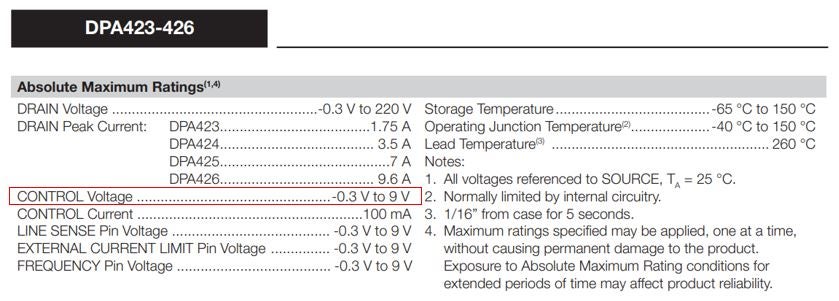

As you have also noticed, the control pin voltage is rising up to approximately greater than 30 V, which means that it is picking up unwanted noise that significantly elevates its voltage level. The C-pin voltage should always be equal to 5.8 V in normal operation and should not exceed the control pin's absolute maximum rating voltage of 9 V (please see attached image) because it will damage the IC. So, there's a high chance that your IC is now damaged and needs replacement.
Since the control pin is picking up unwanted noise that causes its voltage measurement to rise significantly, there's a very high chance that the issue is caused by the layout. The best thing I can suggest is to do a re-layout and follow the "DPA Switch Layout Considerations" that can be found on pages 18–20 of the DPA Switch datasheet and the "Layout Considerations" that can be found on pages 16–17 of the DPA Switch design guide (AN-31)
