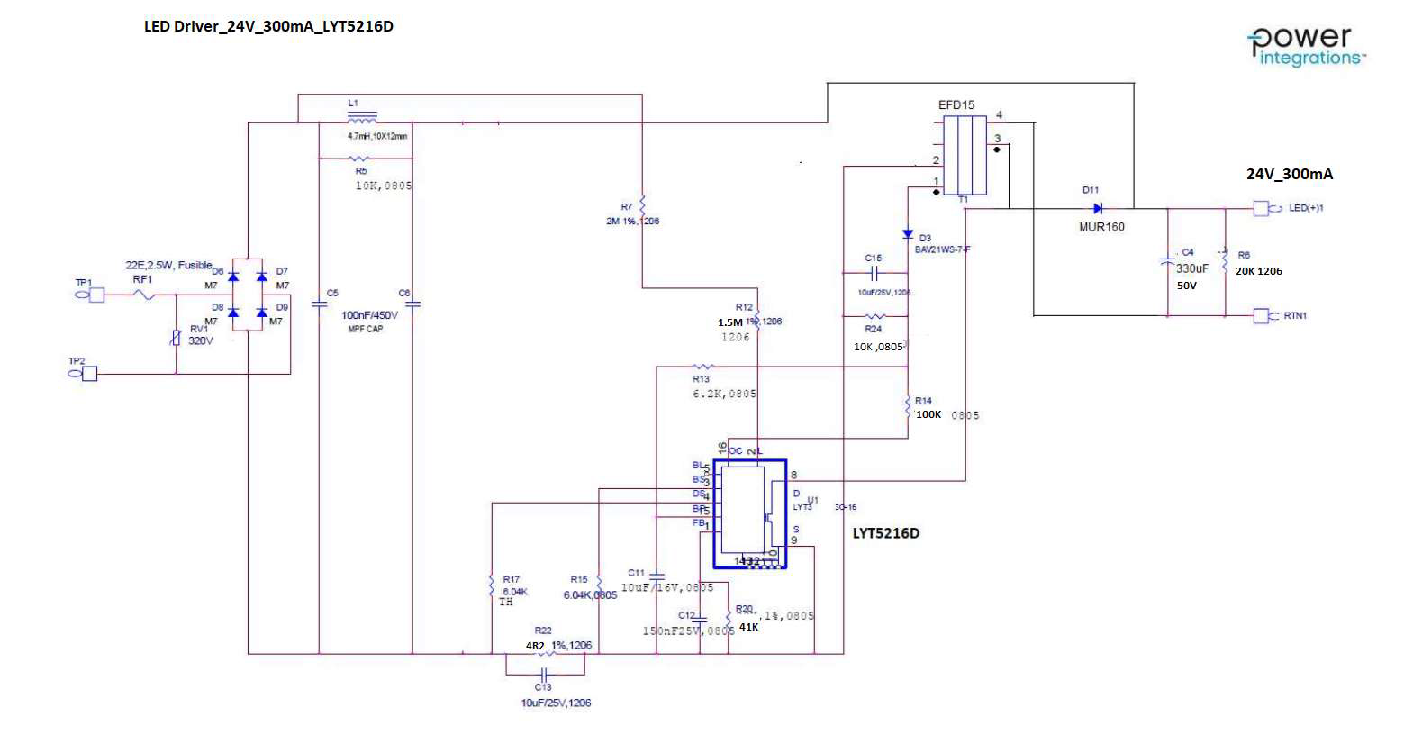

I have used LYT5216D-TL for 24V, 150mA LED driver non-isolated design. I got reference schematic for this requirement from PI's support team and built a proto types around this.
During testing I am facing issue like LED driver board blown out randomly and in all cases we can see that LYT's Source and Drain get shorts along with current sense resistors. I can regenerate issue if I do board power on/off from mains 3-4 times within a 4-5 second.
Attached is the screen shot of schematic. Any insight is highly appreciated in timely manner.

Hi Hitesh,
What topology are you currently using? Looking at your schematic, I assume this is buck-boost? (Please correct my if I am wrong)
Please send your transformer construction and your PCB layout.
Tarmo
Submitted by Hitesh Gambhava on 08/24/2023
Hi Tarmo,
I am using buck topology. Following is our construction windings. Is there any private channel where I can share the layout file?

Submitted by PI-Tarmo on 08/28/2023
Hi Hitesh,
What's the operating input voltage range? Do you have any waveforms on the LYT5 Drain Source during start-up, normal operation, and fault? You can send your layout to my e-mail
Tarmo
