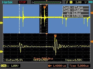

After finally getting the means to look at the fb pin, I can see there is a ringing occurring with a pk to pk value of 6v, of which 2v is below the source reference level. I will attach a scope capture tomorrow. I'm not sure if the ringing is due to saturation, or the switching diode.

I have attached a sample of the FB pin, which shows the ringing on the pin, which corresponds to the leading and trailing edge of a switching pulse.

Thanks for the inputs. The noise your have seen in the FB pin voltage probably came from the ripple voltage across C3 or From noise coupled from the MOSFET internal to the IC. You can increase C3 to minimized the ripple . Also if the noise came from noise coupling generated from the MOSFET switching, you can try minimized the loop from C1 to Drain by adding 10nf/500V across D-S pin.

Did you mean 10pf or 10nf, that would be .01uF, correct? I tried a .01uF first, and it flashed at a dim level right away. Then I tried a .001uF, still flashed, but at normal brightness, and still right away. The ringing on the fb pin was absent I could see. So maybe an even lower value?
