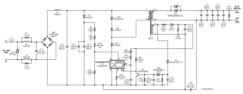

Hi everybody,
I allready desing a driver with LNK410, using PI Expert, I did it with all compenents described, and then, I had output only 5v, I check double twice, I did not find nothing wrong, I take out all diodes to check them and I forgot to solder a blocking diode (fr257), the driver stars prety nice, led string of 75w get full light, but now I can not dimmer without flashing and buzz noise.
question, what is happen? if I put the fr257 this make output drops, and star uneven reading at all.
in ther way I take out the fr257 and star ok, but with out dimmeraizing.
can you help me to fix it? , schematic included

The diode is used for clamping the drain voltage and make sure that it does not exceed the breakdown voltage (725V). It is therefore necessary. Please check your connection or optimize the clamp circuit. I attached a sample DER that used a diode-TVS clamp. You can try that instead.
