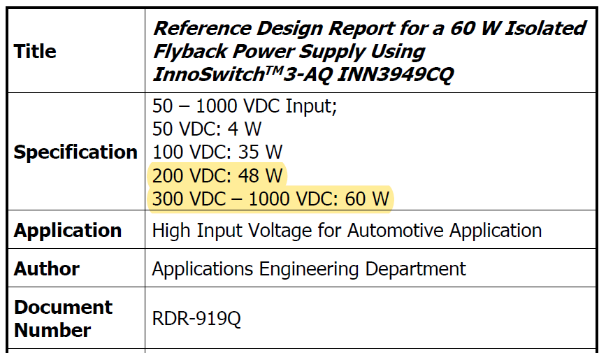

I tried to design 60W 15V flyback converter using the solutions provided by your esteemed company. With a design constraints of input voltage variation from 250VDC to 550VDC and 60W, 15V output I found INN3949CQ in similar range. It would be great if you can kindly provide some insights on the performance of the converter at 250VDC as input.
In the sample design documents available in the website, I found that no information is provided for the input voltage in the range of 250VDC (300-1000VDC is specified as well as 200VDC is specified). I would like to know more about the efficiency at 250VDC as input.
