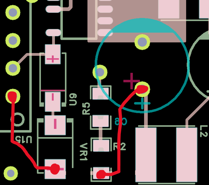

The current layout looks great. Just a few more recommendations regarding the re-routing of some traces. Please refer to the additional recommendations below for your reference.
  1. Instead of connecting to the input inductor L2, the resistor R2 should be directly connected to the positive terminal of input capacitor C6. Please refer to the attached image for your reference (Connection of R2 and VR1).
  2. The same goes to the anode terminal of primary TVS diode VR1, it should be directly connected to pin 1 of the transformer. Please refer to the attached image for your reference (Connection of R2 and VR1).

Connection of R2 and VR1.png (90.98 KB) 90.98 KB
