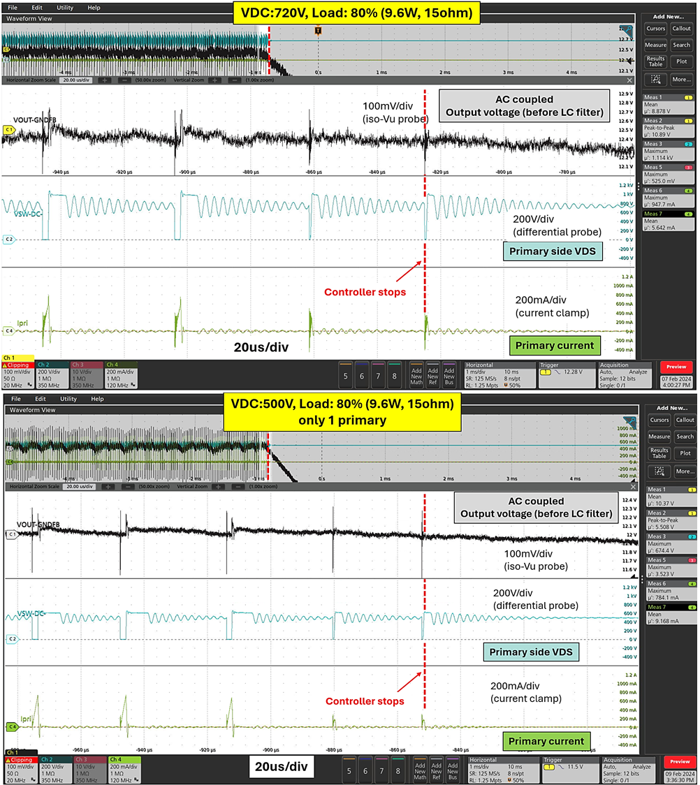

I'm attaching the shutdown event waveform

If you are using INN3165C, you are operating way above the maximum rating of the IC. The peak drain voltage the device can handle is only 650 V. Based on your waveform, the primary drain voltage reaches above 1 kV already. This is beyond the safe operating region of the device and most likely it is trying to protect itself to prevent further damage.
You may need to limit your input specifications or use a different device for your application. InnoSwitch3-AQ Family devices are used in automotive applications and have products with a primary SiC switch that is rated up to 1700 V. Just note that the transformer design must be updated because the Innoswitch3-AQ Family generally has a higher ILIM and that may risk saturating the transformer. I have attached the link below for the datasheet.

Oh sorry for not giving the bigger picture. The flyback under test incorporates a StackFET like ckt to operate at higher voltages (2kV intended). The tranformed also has been designed accordingly.
I cannot share much details on the forum as its a confidential design, but its been validated in simulations along with load, line variations. Peak voltage observed on the innoswitch DS is much lower than 650V.

In the latest waveform you captured, it looks like the primary switch turns off prematurely in the last 2 cycles. You may need to check if the necessary current is being supplied to the BPP pin and that its voltage does not drop below the typical value. Monitoring the SR DS and GS voltage can also give you more information regarding the unexpected shutdown event.
For other protection features, you can check  the SR Short protection and SOA protection in page 5 of the Innoswitch3-CE datasheet. If the design has a primary bias circuit and primary side output ovp circuit, you can check the current passing through the BPP pin to confirm if it goes above Isd (7.5 mA), causing the unit to latch off. You can also check the thermal performance of the device to see if Over-Temperature Protection (OTP) is being triggered.

Update: I replaced the existing inductor with one having half the magnetising inductance and observed the operation.
This time the shutdown occurred at 500VDC (200V lower than previous result). Is the shutdown related to Lm value?
