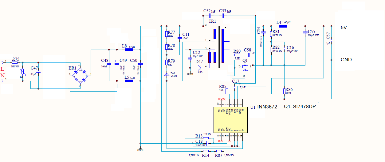

Hi Thomas,
Can you try shorting first the L4 in your schematic or connected the Vout pin directly to the node of C54 (see attached image for your reference)?
If you are using post filter, Innoswitch voltage sense resistor should be connected before the filter inductor.

Submitted by Rutenbeck on 11/04/2024
Hello PI Nanoe,
thank you for your fast response.
i tried to shorten L4 but that made no difference to the effect.
