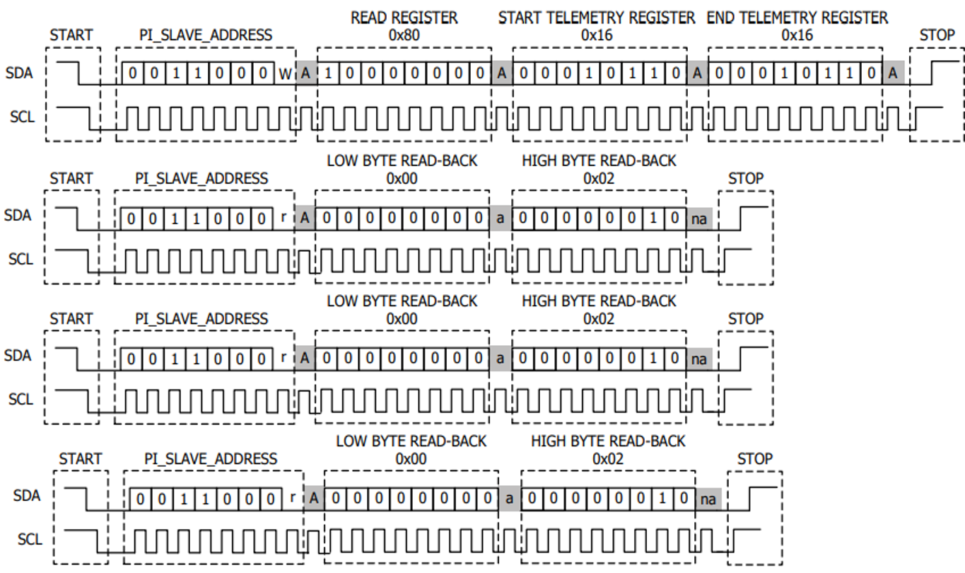

2.) Read back multiple telemetry registers
Reading back telemetry registers allows me to set a start and end register address in the write part of the transmission. How does the read part look like if start and end address differs. Do I just have to read back the number of registers times 2 bytes in one chunk with 2 bytes for each register?

Hi Marco,
Sorry for getting to this late. You can send multiple read-backs depending on the number of registers you indicated between the start and end register.
For example:
If the start register is 0x04 (READ2) and the end register is 0x08 (READ4). You would need three read-backs for 0x04, 0x06, and 0x08.
