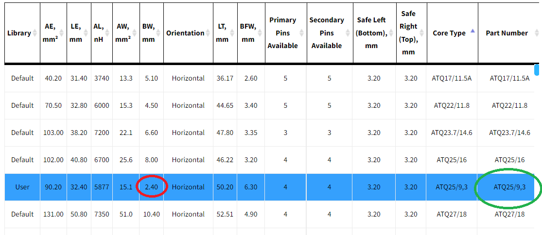

So I entered the core and skeleton parameters into PI Expert Online and... another problem.
The skeleton from "TBI" has a width of Bw=3mm.
http://tbi-tw.com/tbi_dwg/bobbin_th/25-atq/30_atq25-9.3e/TBI-238-09111.12XX(ATQ25-9.3E-8P-THT-1A-12)Rev.1.pdf
The datasheet even says the winding space is only 2.4mm.
However, PI Expert ignores this parameter and adds its own width (here 7.4mm), which is unusable.
Compare the photos: PIE_DesignPIE_Library
Is this a bug in PI Expert, or am I doing something wrong?

If you run the design using PIXLS, you can select the "custom" option and enter the parameters for your core and bobbin.. The design in PIXLS is calling out for fairly large wire, but since the 60W peak is low duty cycle, you can use smaller wire size. I ran the PIXLS spreadsheet as if the design was running continuously at 60W to get an Innoswitch that would be sufficiently large to deliver the peak power. I used the PIXLS spreadsheet for Inno EP.. I've appended  a PDF file of the PIXLS spreadsheet I ran for the the design. You may need to correct some of the bobbin parameters, as I had to guess at some of the values. However, it will give you an idea of the Innoswitch size you need to deliver your peak power.
