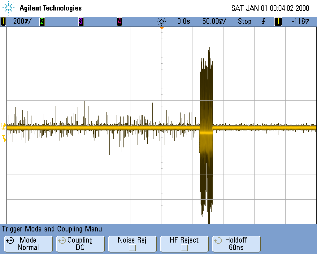

This time i could take some measurements. I don´t have a current probe to measure the drain current of the primary MOSFET.
Vout (39.21 KB) 39.21 KB
SR Fet Gate (43.45 KB) 43.45 KB
SR Fet Source (55.98 KB) 55.98 KB
SR Fet Drain (67.38 KB) 67.38 KB

An output sync fet cross-conduction event can break either the primary switch fet or the output sync fet, or both.  Please share you design files, including layout (if possible). An image file is preferable for the layout rather than a Gerber file, due to layout program compatibility issues.

It would be a good idea to monitor the voltage on the secondary synchronous rectifier, the drive signal to the sync fet, and the primary switching waveform to make sure that there are no cross-conduction events, and that the drain voltage rating of the output synchronous rectifier is not being exceeded. Non-optimal PCB layout may make cross-conduction events more likely.
