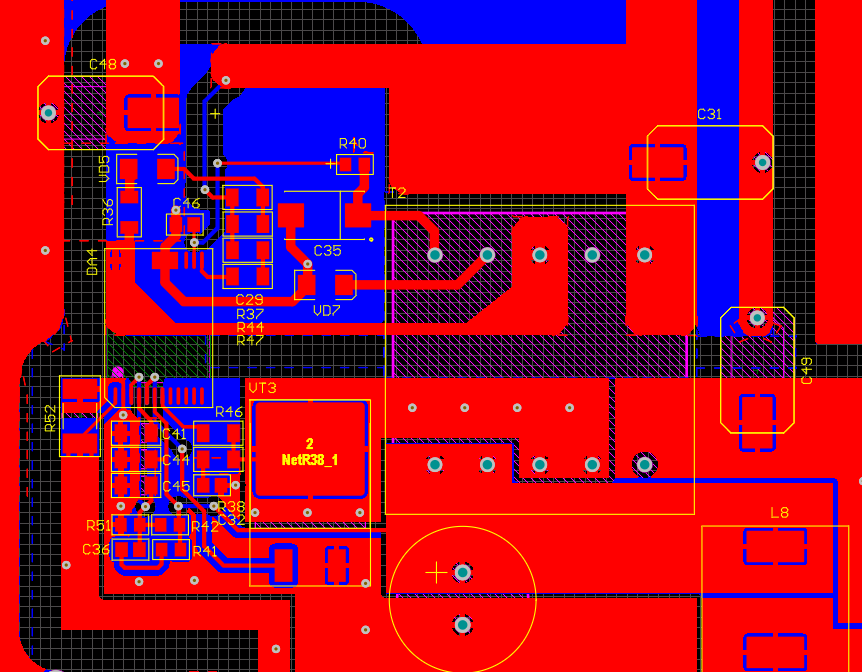

What I meant in the previous reply is, if the current sense resistor (5mohm) is not kelvin-connected in the layout to the IS pin, then the total resistance across IS and GND pins that the IC will sense would be 5mohm + few mohms of trace resistance.
Can you also share the Schematic and PCB layout of your design?
Is the behavior similar at low line input and high line input?
Submitted by Ensider on 02/16/2022
Hi PI-Spark!
Are you saying that the current sensing resistor must be connected to the IS and GND pins with 4 trace? In order to exclude few mohms of trace resistance?Can you send me a Schematic and how it is implemented on PCB.
Attaching at Schematic and PCB layout of my design.
The behavior at low line input and high line input is the same.
Thanks!
PCB layout.PNG (88.68 KB) 88.68 KB
Submitted by Ensider on 02/28/2022
Hi PI-Spark!
Sorry for the late reply.
Yes, I did. Could this be due to a faulty PCB layout?
I've looked at examples of the design many times, too.
To date, I have been able to achieve a smooth change in output voltage in CP mode, but the current still does not increase, more than the value of CC, the value of which is set by the current-sensitive resistor IS.
Thanks!
