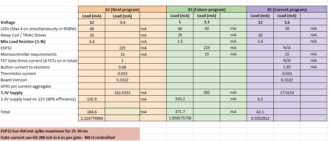

Hello PI Engineers, I need your help with an audible noise problem. I have been struggling to first reduce the 12V ripple (now good) and second reduce the sharp persisting audible noise at various frequencies due to different inductors being used. Please reference the attached PNG file for schematic and Excel file for the loading current values per program.
I am trying to tune L201 and U200.
Loading scenarios:
1) ATTiny microcontroller with 3 LEDs and 5 buttons on 3.3V and relay on 12V. Total hitting close to 42 mA on 12V at most. - This is the X1 program in the excel sheet
2) ESP32 based microcontroller with BT and WiFi on 3.3V and with RGBW LED and relay on 12V. Total at around 185 mA on 12V. - This is the X2 program in the excel sheet
For scenario 2, I have attached 3 pictures at the different loading levels due to the ESP32 micro at power on, standby and WiFi pairing.
I initially started with an LNK3206 and used 680 uH, 820 uH, 1 mH and 1.8 mH as trials. All of them are noisy and change tone as the inductor is changed. This was over 5 dB of noise relative to ambient with each inductor change. And that can be head at 6 inches from the ear.
Then I realized through trial and error that using an LNK3202 + 1.8 mH inductor, loading scenario 1 is resolved. But it did not help in scenario 2 as a high current mode during Wifi pairing will cause the regulator to reset.

Please try to access PI Expert Online and input your design parameters to determine the recommended component values. I have also taken the liberty of generating a design example for your application. See attached.
Based on this, you would need at least a size 5 (LNK3205) to cater to the maximum load. Size 2 (LNK3202) will not work due to peak current limitations. It is also recommended to increase the input caps to 10uF or go full-bridge if possible.
