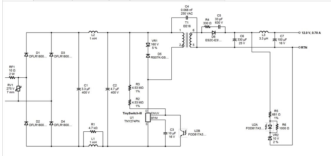

I designed and build a power supply using PI Expert tool for general pourposes. After rebuilding it, i get rid of clicking sound, and now it works, but the output is at constant 3,2V, regardless of Zener diodes that i put into feedback loop. I tried loop as in the schematics, another that worked before in other smps, but its still 3V. I had EXACTLY the same problem when designing another SMPS, but was unable to finish it. I tried to copy feedback loops of factory ready PSUs but without success.
I tried to measure voltage between optocoupler diode terminals. There is 0V at all times. It seems that transformer can't provide enough voltage to rise above Zener voltage and the feedback loop is doing nothing. I followed transformer winding instruction without changes.
All components are brand new. Transformer (ee16 core) was winded (by hand) with PI Expert instructions, and windings are done in right direction, core is also tightly secured. I made in on breadboard for test (I know that's not a good idea, because it may or may not work), but finally it will be soldered properly on PCB. Wiring was checked twice before all was connected to mains.
This is my first SMPS power supply designed from scratch. I made one before, but transformer was made by producer, and it worked both on breadboard and PCB. I'm not totally green in electronics, but I don't have too much experience with SMPS. Please for some help.

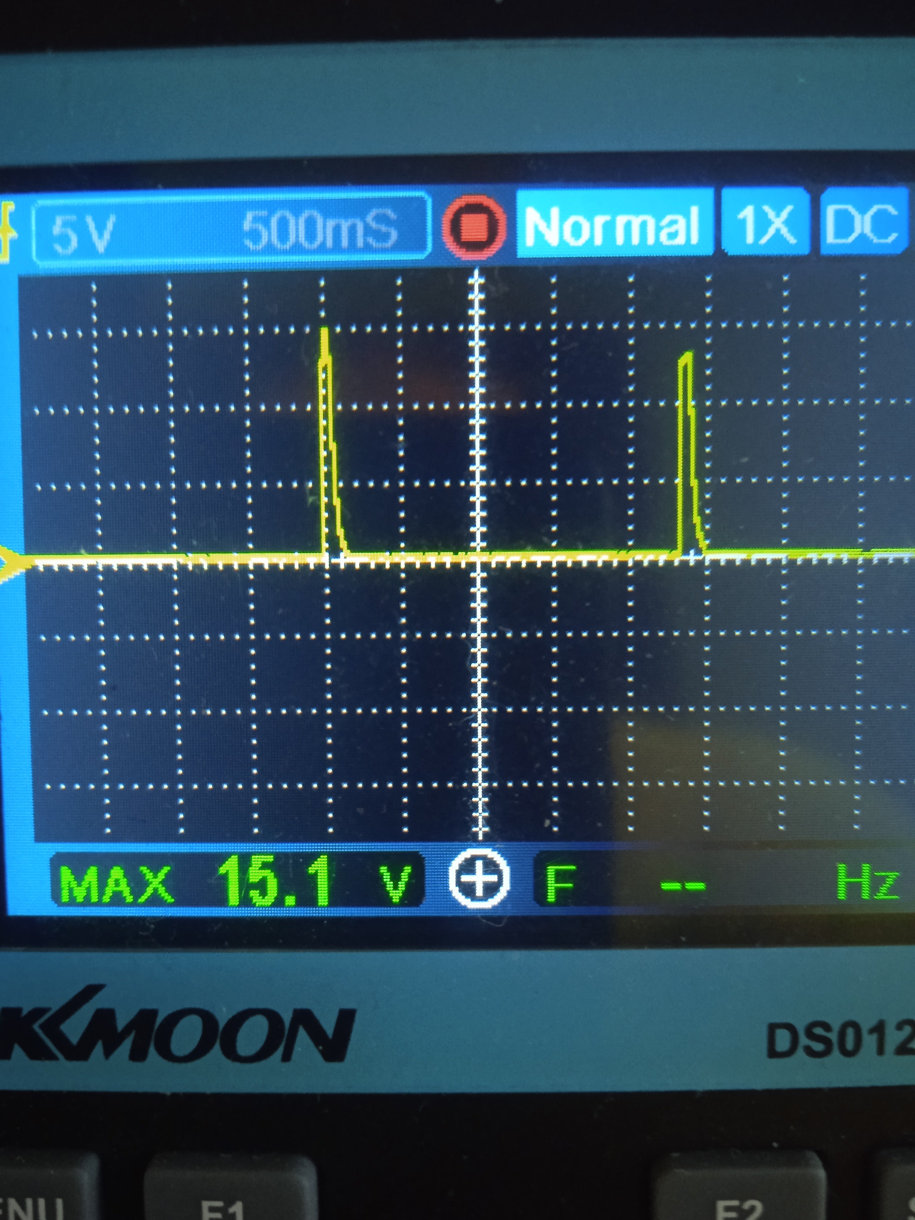

Then, I used oscilloscope to measure voltages on rectifier anode. Measurement was taken in relation to secondary ground. For most of the time, there was a waveform that looks like sinewave of about 300kHz highest point of 3,6V and lowest of -3,6V. You can look at it in attachment number 1. Sometimes for a brief second, there were some spikes of negative voltage that were quite "big" of -6V and smaller positive of +3,3V - attachment 2. The rectifier diode used was UF4007, so it's a fast diode. Output capacitor is a low ESR type.
The output is still at about 3V, when I used both ungapped and gapped transformer.
I also measured anode voltages of rectifier in another flyback power supply that i built myself with LNK364PN, but design and transformer was built by someone else. Waveform is different, with squareish spikes, quite big negative spikes, and its turned off sometimes completly (from what I know that's the effect of feedback loop).

One more thing - in the "spike" waveform you show, it looks like the duty cycle is very narrow, and the output voltage is being clamped to a very low value. Please check the clamp zener on the primary side and make sure it is installed in the right direction, with anode facing B+.

For primary clamp I used P6KE150A TVS, facing in right direction
My design attached

One more thing - your original schematic shows a 10uF bypass cap for the TinySwitch. This causes the part to revert to reduced current limit mode. To keep standard current limit mode, you will need to change that capacitor to 1uF. For the TNY274 ( the smallest Tiny III) you will need every bit of that standard current limit to deliver the power you need. This is only an issue with the TNY274. Another thing you might want to consider is to change the clamp zener from 150V to 180V. The 150V zener sits rather close to the current reflected voltage of ~133V, and may siphon off energy that by all rights should be going to the output instead.

Sorry for delay, I had 24h work shift. My recent steps: added another 4,7uF bulk, changed 10uF to 1uF, added proper snubber for UF4007, changed output low ESR cap (old one was good, so not it's fault), Y capacitor is connected properly. Test load is a 100ohm resistor. I saw that primary inductance should be 2741uH according to PIXLS when gap is 0,23mm, and there are 168 turns on primary. After rebuilding the gap, I have about 3400uH. Its too much. Why there is a divergency between PIXLS and PI Expert? PI Expert's inductance was about 4200uH. I tried changing core type from default to P40, but that changed nothing in transformer construction nor in gaping and primary inductance.
Anyway, there are some different output waveforms. While rectified stays roughly the same (spikes of 15V every "click"), the anode looks "better". There is a square wave every time the circuit clicks, when protection is not tripping, there are only light noises, so I think that IC is not working all the time, but sine from previous waveform is gone. After lowering the inductance, "clicks" have become quieter I think.
From those symptoms I assume that the transformer is saturating, thus overcurrent protection kicks in.
EDIT: IT WORKS! I dropped the inductance with bigger gap to about 3mH on primary, and achieved stable 12V output (with ripple, because i disassembled output filter) with 100ohm load. I'm still wondering why PI Expert and PIXLS show not the same parameters.

From your initial schematic, it appears that PI Expert chose reduced current limit for the TNY274 (the 10uF bypass cap is a giveaway). This would naturally dictate a higher inductance transformer to attain the required output power. With PIXLS, you can manually force the current limit chosen, so I opted for normal current  limit,  as the TNY274 is being pushed very hard to deliver the required output power. This will of course result in a lower inductance for the transformer.
