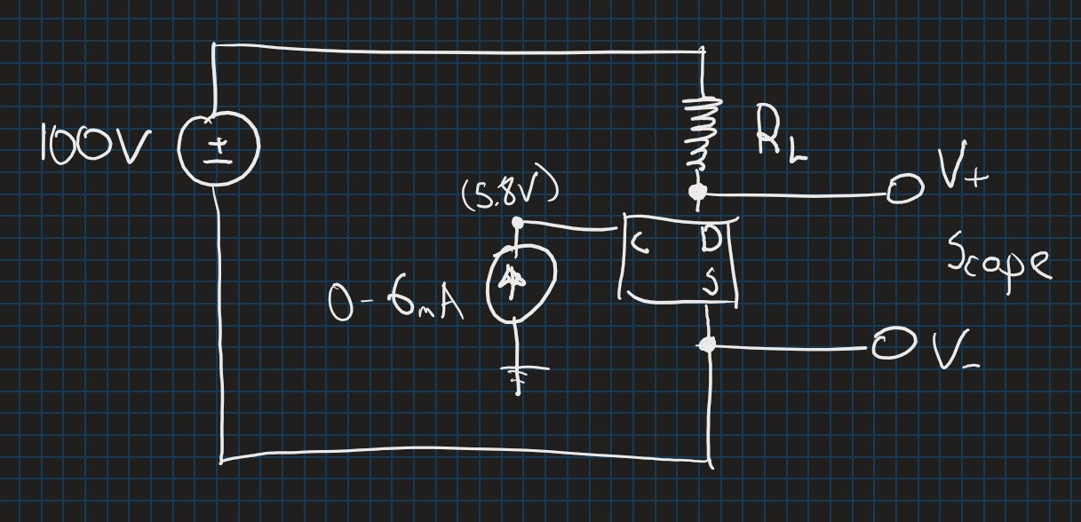

Sorry I should of specified, we've been using the TOP262EN, we were disabling the pins and I neglected to include them in my sketch. Since then we have ran some more tests. We did observe the control pin rising to 5.8V when Vds was 100V but when we sourced current (0-6mA) to the control pin we still didn't see any switching. Attached is a more detailed wiring schematic.
Test Setup TOP262EN_0.jpg (56.56 KB) 56.56 KB
Submitted by so on 11/07/2021
I am also curious about the diode in your schematic, is this necessary for testing purposes?
Submitted by PI-Wrench on 11/08/2021
You should try shorting the V pin to source to allow the TOPSwitch to start at a lower voltage. Also, you absolutely need the 47uF capacitor at the control pin. This is present for every TOPSwitch model (from the beginning) and stores energy to allow the TOPSwitch to boot up. It also serves as frequency compensation for the low impedance control pin. The diode in my test schematic is present to isolate the control pin from the power supply used to drive the control pin, allowing the 47uF energy storage cap to charge via the control pin from current derived from a tap on  the power fet inside the TOPSwitch.
Configuring the control pin the way it was shown in your latest schematic does not provide any impedance to limit the current into the control pin, which may cause abnormal behavior or actual damage. If things go to plan, the TOPSwitch should operate in autorestart mode when you apply voltage from drain to source, and you should see the control pin voltage vary for ~5.7V to ~4.7V. It should then be possible to drive sufficient current into the control pin to allow the device to run continuously at max duty cycle, assuming you have a resistor to limit current into the control pin.
