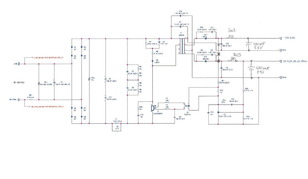

The big question in this case is whether you actually need a power supply with separate grounds for the 5V and 12V outputs. If this is so, then the schematic shown will result in a power supply that cannot regulate, as there is no way for the TL431 referenced to the 5V output to draw current from the 12V output in order to regulate, as the grounds for the two outputs are totally separated.
I have included a schematic that shows the proper connection of R11 to allow the supply to regulate. The top side of R11 should be connected to the 5V rail rather than the 12V. This will at least allow the 5V output to be reasonably tightly regulated. However, the 12V output will fluctuate with changes in the 5V output. This will be especially evident during the 2A peak load on the 5V.
I have also included post filters on the outputs of the supply to filter high frequency noise.
Please try the changes shown in the marked-up schematic to allow the power supply a chance to regulate. Once you have a reasonably stable power supply, we can then discuss the options for improving cross-regulation for the 12V output.

Submitted by nishap on 08/22/2022
Hi, we have made changes to our schematic. we are getting stable output at 5V/0.5A. but on the 12V/0.4A it is still fluctuating significantly. whenever we apply load to any of the outputs the 12V/0.4A is getting affected. please check the schematic and update us.
Submitted by PI-Wrench on 08/23/2022
Unfortunately, since the 12V output does not share a ground with the 5V output, there is not much that can be done to improve regulation other than optimizing the value of the 12V preload resistor R84. !k is probably too high of a value for R84 to help maintain regulation, especially with the 2A pulsed load on the 5V output, which will likely cause a significant rise in voltage at the 12V output. Is the 5V output load relatively static other than the pulsed load, or does it vary significantly?  This will be a factor in the 12V regulation. What is the actual variation in the 12V output vs. 5V load?
Also, what is the regulation specification for the 12V output?  If both the 5V and 12V outputs have a wide range of load conditions, you may need to add a post regulator to the 12V output, depending on the desired regulation spec.
I also noticed something on the primary side of the supply - bulk capacitors C46 and C49 will need equalizing resistors across them to overwhelm the effect of differing leakage currents between the two capacitors. If one cap has a leakage current higher than the other, the cap with lower leakage has the possibility of getting overvolted.

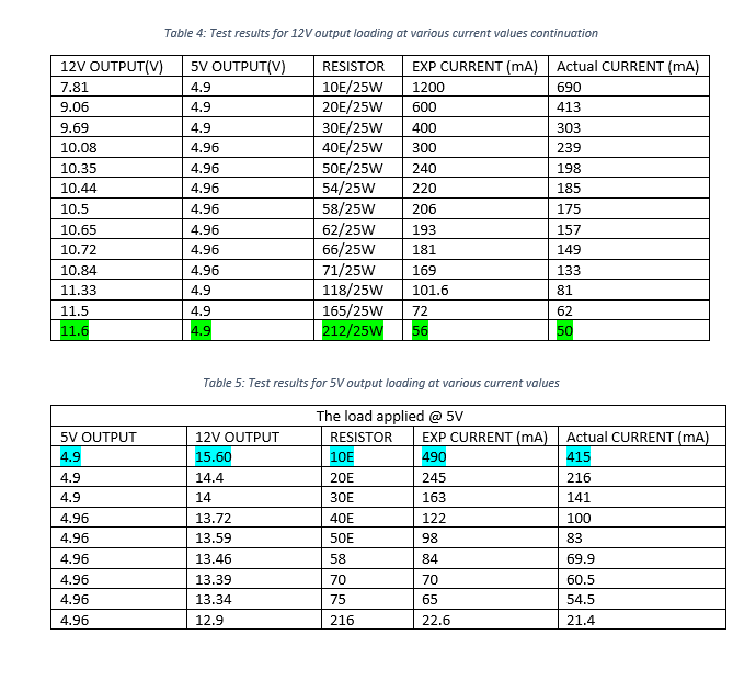

Submitted by nishap on 08/30/2022
Thank you for the solution.
I have something to say.
I am applying a load of 10E/25W at 5V/500mA.  Will this resistor affects? shall I need to opt different resistive load? need your feedback on this.
I have attached the Load sheet. have a look
Thanks in advance.
different loads with different wattages (40.19 KB) 40.19 KB
Submitted by PI-Wrench on 08/30/2022
It is not entirely clear from your chart what is happening on one output vs. the other. What was the load on the 5V output when you were varying the 12V load?. Also what was the load on the 12V output when you were varying the 5V load.?
In order to get any semblance of regulation, there need to be well-defined minimum and maximum loads for both outputs. The 12V output will require some loading on the 5V output to maintain regulation under varying load, and the 12V output will require a well-defined minimum load to maintain regulation when the 5V output is varied.
Submitted by nishap on 09/05/2022
When I apply Load at 5V i.e. 20E/25W I get 5V at the 5V output end whereas on 12V I get 14.4V, when I use Load at 12V i.e. 40E/25W I get 5V at the 5V output and on 12V side the voltage is dropped to 10.8V.
Submitted by PI-Wrench on 09/06/2022
Again, when you mention applying a given load to one output, it is not clear what the loading is on the other output. Clearly for this output configuration, a no-load situation on either output is not desirable.
In the case of the 5V output, the controller will adjust for optimum 5V output, and the only thing controlling the 12V output will be the coupling between the 5V and 12V output windings. This means that the regulation will be far less than perfect, as the 5V output will regulate to suit itself without any input/feedback from the 12V output.
On your schematic, a 2A peak load is mentioned for the 5V output. I would suggest applying  that maximum load to the 5V output and adjusting/increasing the 12V load until it comes into regulation. This will define the minimum load for the 12V output for your setup. Conversely, with that minimum load in place for the 12V output, then adjust the 5V output load lower to define the minimum load for the 5V output that keeps the 12V output in regulation.
In a situation like this, I would not expect any better than around 10% regulation for the 12V output.
If this is not acceptable, you need to consider adding some turns to the 12V output to provide adequate voltage headroom  for a post-regulator of some sort. Even a post-regulator will not work in this situation without an adequate minimum load on the 5V output to keep the 12V output alive.
