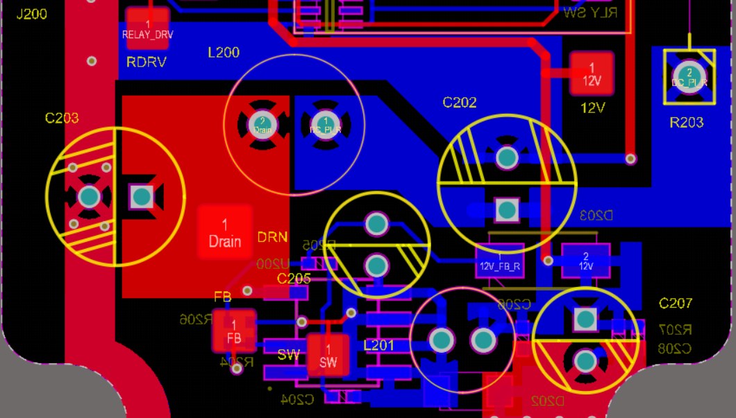

Please find the design attached. We want to get it down to 100 mV. Would really appreciate your help.

  • The PCB Layout needs some modification to further optimize the performance.
    • The loop formed between the inductor (L201), freewheeling diode (D202), and output capacitor (C207) should be kept as small as possible.
    • The loop between the input capacitor C203, IC DRAIN pin, SOURCE pin, freewheeling diode (D202) cathode and anode should be as small as possible.
    • The EMI performance of half-wave rectified designs is improved by adding a second diode in the lower return rail. Checkout D4 on datasheet page 5.
    • Source trace shouldn't overlap with FB and BP pins.
    • C204 should be located physically close to the SOURCE and BYPASS pins. Relocate the traces so that no trace is passing through the center of the IC and make sure that enough clearance is provided, especially around the drain pin and the control components.
    • C203 should closer to drain pin.
    • The output trace is too close to the AC input trace. Observe the proper power flow from input to output as suggested in page 4-5 of the datasheet.

I checked the loop with L201, D202, C207 is small. Should that be made smaller?
Loop for C203, Drain are on one side of the chip and D202 is on the other side as it is a free wheeling diode. If I move it close to C203 and Drain, I will be moving D202 away from Source (SW node). Is this necessary?
You mean add a second diode in the neutral line? Why is this needed? Neutral usually should not have high voltage there right?
C204 is very close to Source and Bypass, it is below the chip. Is this what you mean? The Bypass_BP/M trace going through the center of the IC is a problem? I see that it is going next to the Source trace. Is this a problem with coupling? Again, same thing with having testpad on top layer?
C203 is part of the PI filter - is the concern that we should have a closer coupling to Drain?
I realize that the AC input trace is close to output but at this point the voltage is rectified and 0.72 mm away. How much clearance do you suggest?
