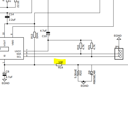

I've tested the code on our test board with Inn3370C IC. I've seen no issues so far with it. Based on this, I believe that it is not the code that is the problem but some other protection feature is being triggered. Does the shutdown voltage change with input line voltage?
Also, could you check if R14 is indeed 10Ohms 1%?
R14
And lastly, could you help me by using uploading Inno3Pro_Serial. Open serial monitor and setting OV = 10 and afterward CV = 8?

Submitted by Rahul Surawase on 08/27/2021
Hello Sky,
                  Ohk, I replace R14 as per your suggestion with this part,  https://www.mouser.in/ProductDetail/Bourns/CR0402-FX-10R0GLF?qs=URDPQ%2Fj0cz2NyGyYyiFF9A==  But there is no any change in results
i check serial code as per you suggestion 1st i tested with 5V which i shared log and after that i checked 8V configuration i attached log file
also i shared Plotter log for system behavior with and without load please take a look.
