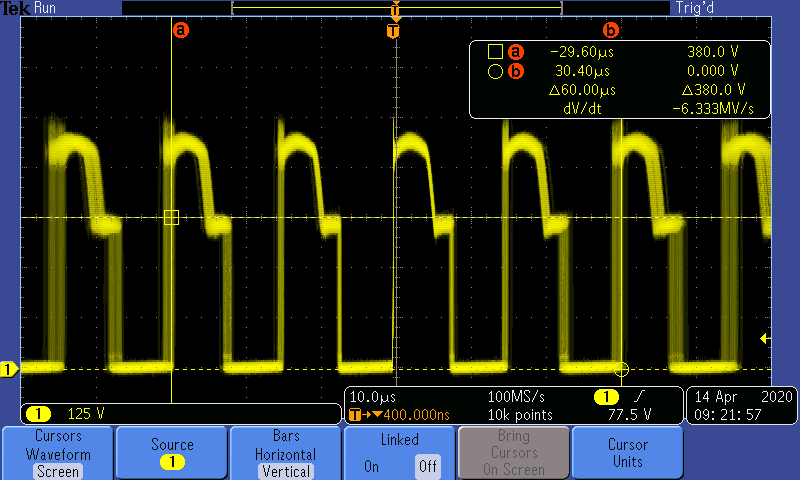

Submitted by robindavis on 04/14/2020
going to upload some screenshots of various drain waveforms under different load conditions.
No load , very light load(200mA) , 1A , 5A , 10A , 15A and 18A loads. Bus voltage is 380V from the PFC. This can be seen as indicated by the 1 cursor on the screen.
Submitted by PI-Wrench on 04/15/2020
The overheating of the zener clamp option indicates that you might have either too much leakage inductance, too little primary magnetizing inductance, or both. Since you are operating at 66kHz, there is no need to gap the core to reduce magnetizing inductance. If you haven't already done so, splitting the primary winding and placing the secondary between the to primary halves will greatly reduce the leakage inductance. Your high power drain waveform shows a big leading edge spike that may be indicative of excessive leakage. It would be useful to see a pdf of your transformer design file.

Just out of interest. I had a transformer with a higher primary inductance. 24mH I think.
I noticed that under higher load the the drain voltage after the fet's switch orff (the reset stage I think) would start to clime very high , approaching 700V. Could this have been due to the transformer saturating? I don't have enough experience to be able to tell exactly what is happening just by looking at the waveforms :0(

Submitted by PI-Wrench on 04/16/2020
With a proper clamp design, the reset voltage shouldn't get anywhere near 700V.

Submitted by robindavis on 04/16/2020
I was wondering what could cause this behavior though. At about 10A load , the drain voltage is fine , but above this it starts to move up with increasing load. What causes this behavior?
I will be redesigning the xfmr , but I'd like to understand what is causing this issue so I know what i'm looking at if I ever see it again. I'm assuming it's the transformer starting to saturate , but I'm not sure.
