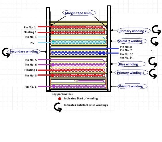

I am attaching Current construction.

My transformer details are as per following
ETD-39
L p = 383 uH.
1)Primary = 31 T (2 x 26 S.W.G)
2)Secondary = 3 T (4 x 21 S.W.G)
3)Bias = 3 T ( 2 X 30 S.W.G)
Shield I have used 30 s.w.g 48 T
4 mm margin on both side of core;.
Suggest me a better architecture of transformer for radiated emission test results.
and it is ok to use flux band over core and connected it to bulk ground.

Hi Rajyavardhan,
I do not have all of the specifics for your transformer like turns, wires, cores, layers, strands etc.
If your question is related to Screen 2 then, increasing the number of strands is used for reducing the turns and total stack height when still keeping full layer for better shielding effect of that winding.
For your power level I would replace Wound Screen 2 with single turn of foil with a center connected lead along the turn.
You may have a better results when Removing Shield 1 and connecting the core to a quiet point via very short lead.

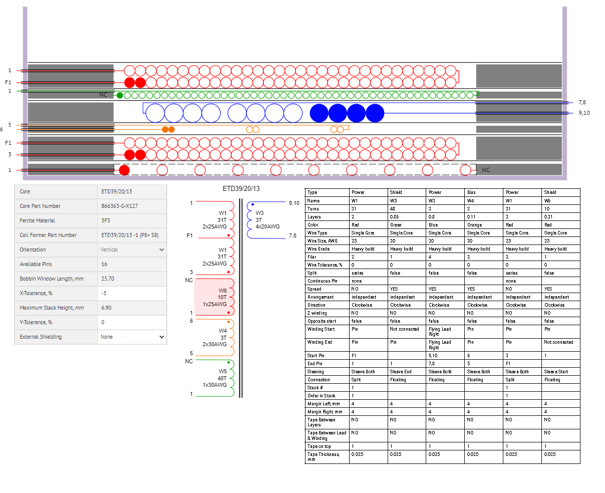

Submitted by PI-Yoda on 11/14/2020
Hi Rajyavardhan, thank you for sending the transformer information to me.
Please look at the attached picture and let me know if all of the stack and schematics information is correct.

1. I would recommend removing the first layer shield and attaching the core to HVDC buss line with very short lead.
2. replacing the wound shield W5 with a single turn of copper foil. The lead soldered to the center of the foil and pin 1(HVDC bus) to be also extremely short.
3. The same copper screen to placed between Bias WD4 and secondary WD3. Also connected to pin 1 or HVDC buss if different.
4. Use TIW for secondary and remove the safety margins
5. Reduce primary layers to one and single strand, but increase the diameter of it to fill the layer properly.
6. Use copper flux band as shown on the picture.
On the picture is also shown the suggested transformer.
