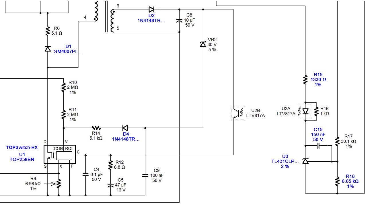

I made a 13.8V, 8.4A AC-DC power supply using PI Expert Online. The PI device used was TOP258EN. The suite suggested a 590Ω resistor for the optocoupler LED. This would result in a current of 23mA through input LED which would result in 37mA through output of opto.
The largest value I could select for the given design without an error was 1330Ω. This would result in at least 10mA flowing through the opto input. Which would result in a current of 16mA flowing through the output of the opto.
Both the values were verified on the physical prototype by disconnecting the output side of the optocoupler and measuring the current flow with different resistor values for the input LED.

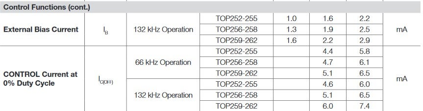

However, in the datasheet for TOPSwitch HX series convertors, the Control pin current for 132KHz operation is specified as 1.9mA typical and 2.5mA Max. The absolute maximum is 100mA and well withing the maximum current through the opto(50mA). The CONTROL Current at 0% Duty Cycle or IC(OFF) for TOP258 at 132KHz is 5.1mA typical and 6.5mA Max.
My convertor is not producing any output and seems to be stuck at soft start. I was wondering if the current outputted by the opto must be stopping the device from powering up. Is there a chance for the IC to have been damaged by excessive current through control pin?

I am not sure how you have calculated current flowing through the optocoupler LED, Generally current flowing through the Optocoupler LED is determined by TL431 Error amplifier output not the resistor so much. Resistor sets gain of the open loop transfer function.

I disconnected the output stage on my board from the transformer and powered it externally with the expected output voltage. The output part of the optocoupler was removed from the board and given a power externally. I did that to just check whether my feedback elements were functioning or not. TL431 is behaving as expected and the opto gets powered on when the reference value is met. Now I understand how the current through opto is not solely dependent on the resistor after reading your reply.
