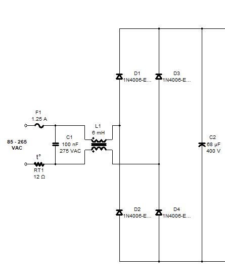

To making the calculation easy, I generated another smps using topswitch with 28.5Watt output in TOPswitch HX.
I have set the output at 12.0V at 2.37A.
Therefore, PI-Expert give me another SMPS with a simple HV filter. Can I use this one?
I am sharing you the images for your convinces.
I also read somewhere that the EMI capacitor C6 across the transformer T1 is directly linked with input choke.
So my planning is to use the circuit portion of the HV DC side and the value of the C6 with my previous design of 28.5Watt accumulated TNY switch SMPS.
What is your opinion?
Submitted by papaisou11 on 09/11/2020
Sorry to mention. As my previous design has three individual smps, I will share the capacitor C6 value.
Thus 0.11 (Approx) nF in each smps.
Submitted by PI-Kobe on 09/11/2020
I think what you did was a good starting point. As far as the input side (bridge) is concerned, as long as you design using the required power, you may be alright. Just take into account efficiency and properly adjust the ratings of your bridge components. As for the EMI, you may use an input choke and a high input bulk capacitor usually helps, however, there would be numerous ways you can optimize your design if EMI becomes an issue later on.
