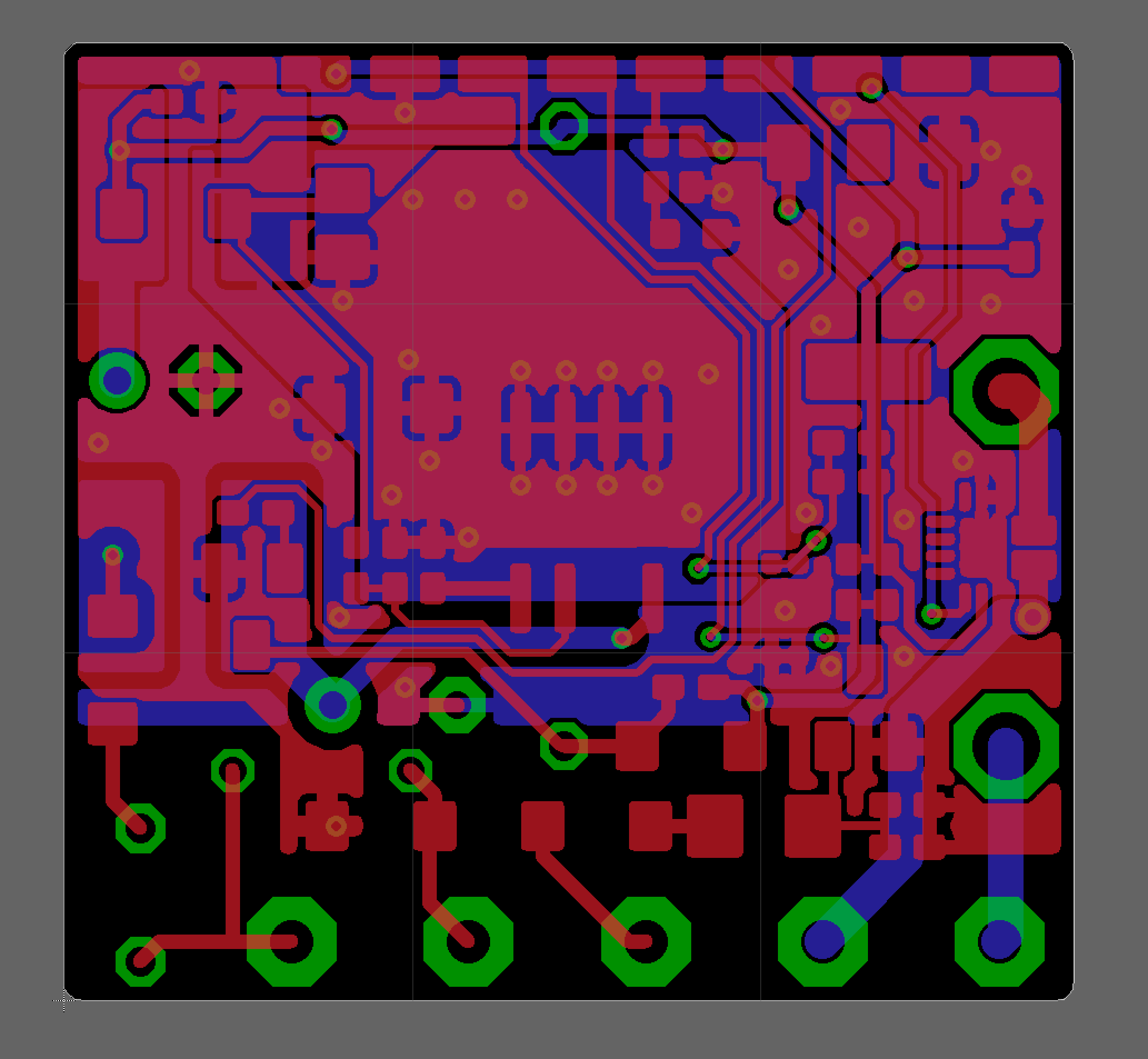

Please see pcb layouts attached. For power part we just have 10 x 27 mm area as application requires this. 2nd revision of pcb has 4 layers, two of them are GND plane but result is same
Previously we made 3 different products with same components and we didn't have heat problem. But these boards were bigger sized (almost double).
For the heat-sinking area there is a drawing in datasheet but no dimensions were indicated. Our heatsink area is 9x11 mm.
As we used PIExpertOnline while making calculations and component selections; we would reach up to 350mA without problem but even at 200mA; temperature rises into 85-90 C.
I will check switching shapes but how to measure inductor saturation? In fact we even used a 1mH & 750mA inductor, result was same.
Regarding thermal check; we even have thermal problem at 25 C ambient temperature, 70% output power and max input voltage. So, it will not pass.

Hi Qawasmi
Please have a look at the picture attached.
Rough estimation shows that on the bottom side you have 40-45mm^2 copper area. Some chunk of it is covered by D4 which is already hot and area around D4 is not actually sinking heat.
So, more real estimation – bottom side is close to 35mm^2 actual heat dissipating copper area.
Let’s assume that on the top side is 10x10 = 100mm^2, but this heat-sinking part could be only used when the heat passes through single connection – C4 +pin. This bad thermal connection between both layers makes the effectiveness of the top layer cooling very low.
It is not far of to approximate your actual effectively cooling copper area as total of 100mm^2.
PXLS Designer shows that for 220mA load the power in the controller is 360mW.
1. Datasheet case (Page9/package D) - Copper 232mm^2 – gives Rth = 100DegC/W
0.36W*Rth = 61Deg C on the pin on the controller for 25Deg C ambient.
2. Solving back for you design case (80DegC on the pin) gives your actual thermal resistance as 152DegC/W.
In summary - even you circuit works ideally - as per the examples, the cooling copper area of the controller is by far too small from the one needed to guarantee 100DegC on the pin at min. mains and maximum power (Datasheet, p8, Quick design check list, point 4).
I will recommend to redesign the PCB to provide more cooling copper area. If this area is on two different layers to provide PROPER thermal paths between the two layers. Maybe using a lot of metalized vias.

I've made a complete re-layout for more cooling, but still see about the same results.
Please refer to schematic below for the exact components used.
The area of the Source pad (cooling), is now 268 mm2, 100 mm2 on the top side and 168 mm2 on the bottom, with several vias.
Board layouts are attached, some with the Source pad highlighted.
Also, a chart of efficiency and temperature vs current output.
Input was 225V AC.
As you can see, efficiency is terrible, tops 47% at the most.
Temperature is a little better than before, but still way too high (which is, of course related to efficiency.

A second problem is that the Source pad needs a lot of copper to dissipate heat.
On the other hand, as it is the switching node, it needs to be as small as possible for EMI reasons.
I haven't measured noise, but there was enough EMI to upset my handheld scope that was lying 10 cm from the board, and make it flip around in the menus by itself.
Not a good sign.
