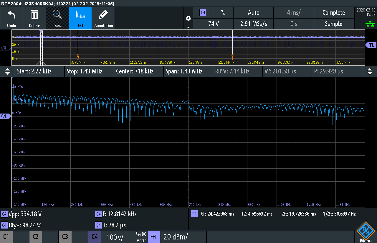

In our application the output of the chip creates an oscillation around 800kHz which goes out of spec during Conducted Emissions testing.
The oscillation frequency does not drift / change over time, it is also not depending on the amount of power drawn from the output. The oscillation frequency is affected by changing components and/or the board layout(but the amplitude not so much).
By using the recommended filtering and board layout we can get the normal switching noise well below the CISPR limits but the 800kHz peak amplitude remains unchanged.
The attached FFT https://ac-dc.power.com/sites/default/files/forum/files/SCR97.PNG image shows the level of noise is around the same level of the normal switching noise but the PI filter on the input does net prevent his from getting fed back to the mains grid.

Yes we've tried. we tried multiple filters this does not prevent the oscillation of the MOSFET and has only limited effect on the peak amlitude of the oscillation measured in the conducted emissions test. We have another design incorporating the LNK306 which does not have this oscillation. We've been trying to fiend the key difference between the designs and have not found anything critical yet. What we did find is that when we connect a differential probe (50Mohm / 1,25pF) between the Drain and Source of the MOSFET this design also starts to oscillate. After doing some more tests we found that adding a loos wire with a lengt of about 10 centimeters to the source pin of the MOSFET it also causes the otherwise normally functioning design to start oscilllating. The IC/design seems verry susceptible to oscillation based on electric/inductive coupling. Is there an easy way to make the LNK306 MOSFET less senstive ?
