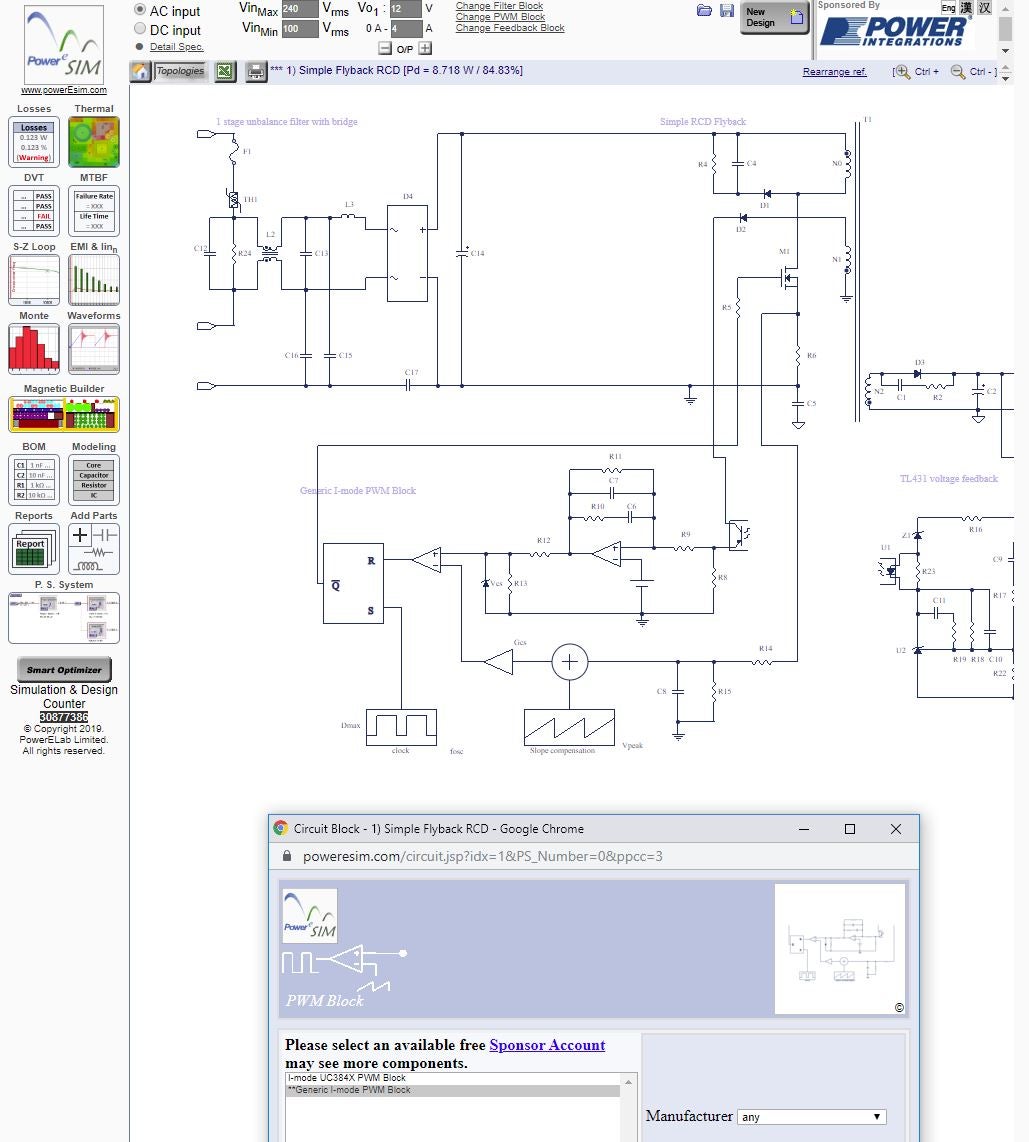

Submitted by jacob3204 on 12/02/2019
Hi,,
Please see attached
I selected a simple flyback schematics
Power integrations selected as vendor
However i cannot see any parts
The part iam interested in was TOP264EG

Submitted by PI-ODO on 12/06/2019
Hi Jacob,
I connected with PowerEsim, and here is the procedure to access our TOPSwitch-JX PWM circuit models.
Go to the Topologies page and click any topology in Integrated Switch Flyback, or click “Flyback PWM+S AC/DC” on the front page under “Start a Design from Topology." Then click the PWM module headline and select TOPSWITCH JX.
