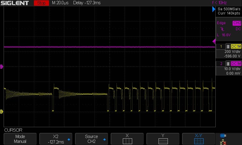

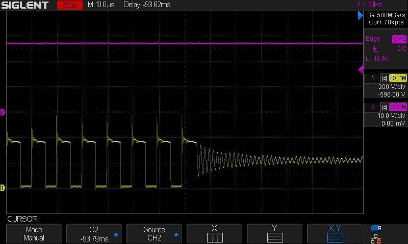

In the attached screenshots you can see 12v output at CH2 and Drain voltage at CH1. There is a screenshot that represent the whole problem and two that zoom the drain waveform at start and end of the abnormal regulation.

Can you please capture waveforms similar to the one I attached and then zoom in the waveform where there is first skipped cycles. After 1 ms of continuous switching, there should be some 2-3 switching cycles skipped (30-60 us of no switching) indicating secondary takes over control from primary. We need to know if secondary takes over control or not since over voltage condition like yours occurs when secondary fails to take control and why is it failing to take control.

During the abnormal regulation seem not to be skipped cycles, I zoomed and scanned all the window, so the secondary seem not to take controls.

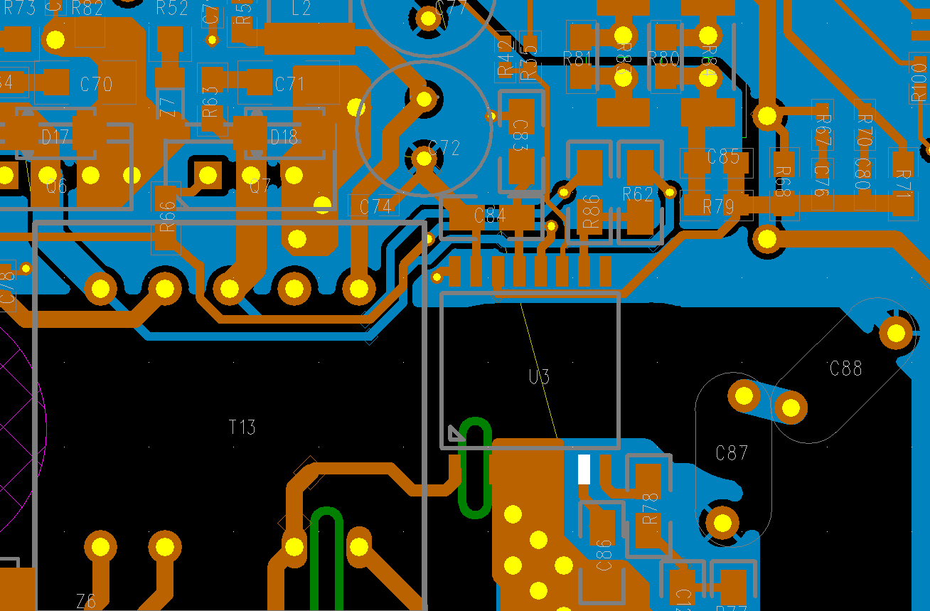

Attached you can find also an extract of board layout.
Thank you for support.

Anyways your waveform 4 is what I was looking for. Once the BPS voltage reaches ~ 4.4 V, the secondary takes over control. This is happening almost after 1.25 ms of start up. I cannot see the initial start up pattern at the moment when the BPS voltage reaches 4.4 V in the waveforms you sent for the abnormal case. Can you please zoom in at this point where the BPS voltage reaches 4.4 V for the abnormal condition so I could know how is the drain switching pattern at this moment?

Attached you can find the requested screenshots. Sorry for bad resolution, but you can see that the startup event occurs a long time before the issue. At that time the BPS is already at 4.4V.

If you observe in scope 2 and 4 captures, there is almost 50-60 us of no switching activity at the moment when BPS reaches 4.4 V which means that the secondary did take over control.

Is your FB trace close to any noise trace? Can you share your layout ?

I already shared the layout, you can find it in message #5. There aren't noisy traces near the feedback line, but from capacitor to feedback pin, the trace is quite long.
