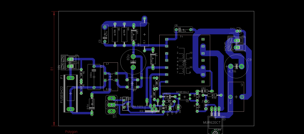

This is my first project with TOP drivers, so I have a few problems with that. I count for your's help.
I performanced the flyback converter with TOP 258YN driver (photos at attachment). My desired parameters are output voltage: 12V, output current 8A. But I can't achive the desired parameters. Maximum current is 1,23 A but voltage go down to 6,5V.
In attachment are results of my converter. My converter works in current limit but I don't know why.
One thing I can add the circuit which will help in switch off transistor (based on diode, capacitor and resistor), this circuit can reduce value of oscilating.
What do you thing about value of resistor in transoptor loop?
Could you help me in my problem, please?
Thanks for help.
PCB design (48.69 KB)
Drain current (2.37 MB)

It would appear that your Lpri is not 260uH as seen in the drain current waveform, what are the primary turns and air gap? on what core?
Also the sec loop is too big (open) for 8A out ( 32A pk) you need to use both halves of the o/p diode, also the pri side power tracking is too open as well.
You need to heatsink the pri device and the o/p diode quite well.
Check you have the Tx the right way round ( pri and sec swapped ) ...
good luck ...

Hello Easy Peasy,
Transformer parameter:
- primary turns: 43
- core: ETD29-K-H-5.0, Phenolic T375J
- no air gap
Yes I use heatsink to diode and TOP switch.
What does mean too open for you?
