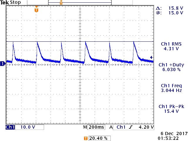

I generated a design on PI Expert for a rough test on a controller I want to bring up. There were a few problems I saw generated by the design that may or may not be my mistake. I have attached a schematic for reference. Layout is by the books and almost 1:1 matches TOP265 datasheet with the exception that I am using SMT parts on this project (the primary switch node connection could be larger and will be on final rev). Note D301 is a DNP placeholder on the board and R310 has been removed.
In initial testing, R310 was causing problems when the output was loaded with 6 ohms. Upon inspection of the Control (C) node, I noticed that control was falling below the 4.8V line and causing autorestart cycles. Removal of the R310 resistor solved that problem and heating of the snubber and TOP265 stay below 75C at all times with a 25C ambient. Not a big deal. I am working on adjusting C304 and R301 to minimize ringing further, but this is a small side problem as my temperatures are good and we are not hitting an avalanche point under max load. Ringing attached for reference.
Now, the issue I am seeing at max load only happens initially when the system is cold. When I apply power (through 15A switch, fuse, and FW rectifier circuit), the output will hiccup for about 5 seconds. Once started and warm, this issue no longer presents itself, but if I power things down, then walk away for an hour, this issue is repeatable. I have inspected the (C) node during this event and again, I am seeing the (C) node drop down to 4.8V for these cycles.
See attached hiccup/autorestart image.
I suspect there is a gain issue of the U301/R306 combo so I have been adjusting R306 downward to 6.8k/5.6k. My problem is that the nature of the issue makes testing and verifying this very time consuming and tedious.
What ideas do you PI experts have and is there an issue with what was generated online? It would be nice to know why R310 disables my output at any kind of load since it should strap us slightly above 1.5V across the diode of U301.

See attached plots.
Nick
