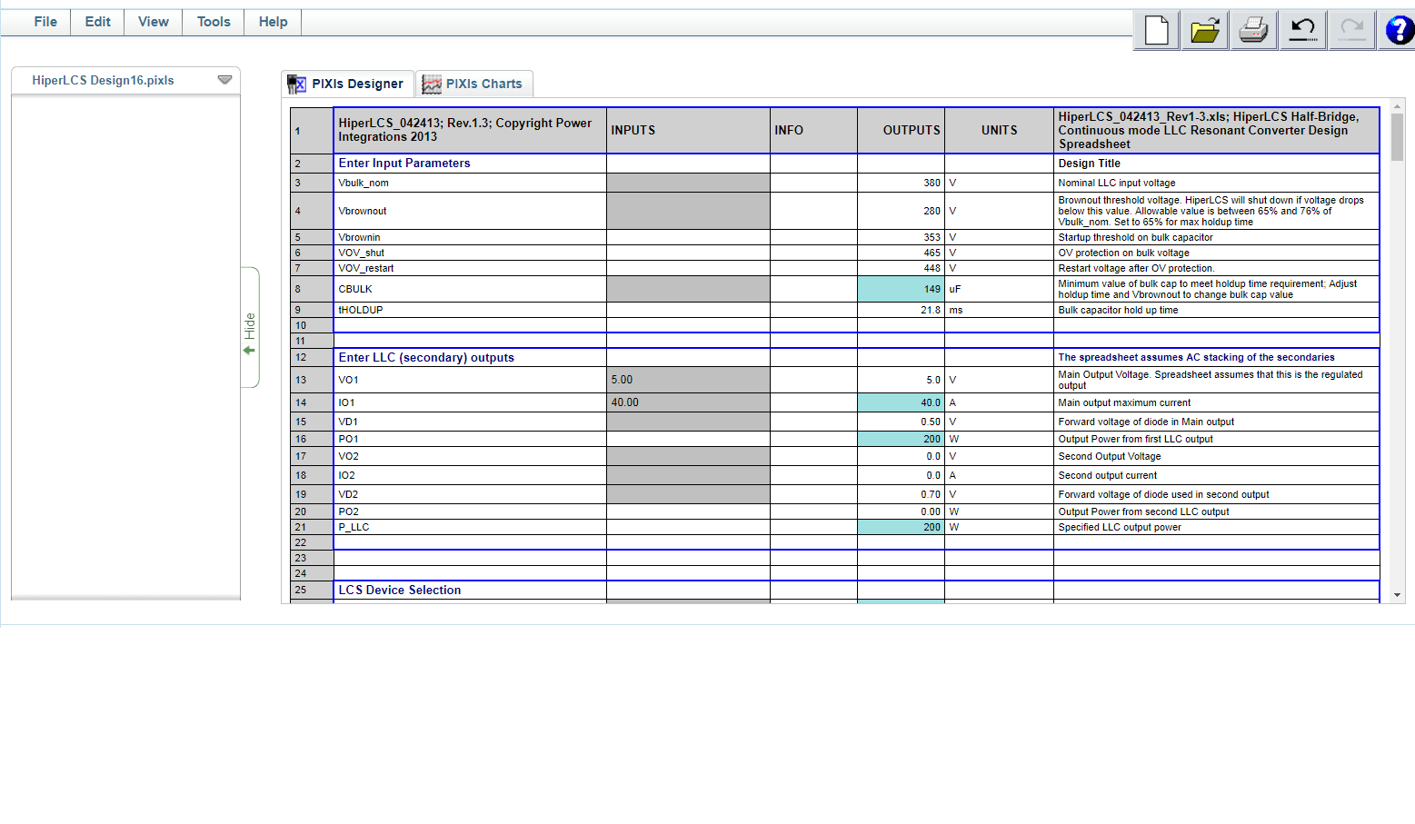

Submitted by rejithcvcv on 09/04/2018
Thanks for the reply. But in the PI expert software, the current can be set to a maximum of 12A only. How can we overcome this situation?
Submitted by PI-Mallora on 09/07/2018
Maybe your power setting is not set >100W. See attached file for your reference.
Output power selection (175.64 KB) 175.64 KB
PIXls input_5V_40A (63.24 KB) 63.24 KB

Submitted by PI-Mallora on 01/25/2019
Hi sadashivmirgule,
Please check attached file. HiperLCS is in available option. If you can't see LCS option, try to remove product filter by selecting "Any" on all filter parameters.
Upon log-in then create new design (211.68 KB) 211.68 KB
PIXls input_5V_40A (76.25 KB) 76.25 KB
