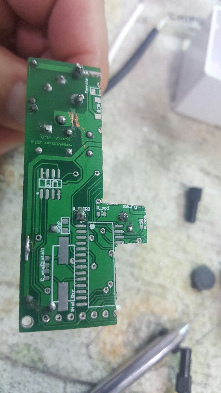

3) Start cutting pieces of the PCB, and sense again the IC, I realized everytime I cut some part, the temperature was lower, but not enoguh.
4) When I get the minimum size of the PCB, I started to remove copper areas, the GND area. After several trial and error, I got the minimum PCB modified, with no problems of heating.
The pictures are Test_A1, Test_A2 y Test_A3. After 10 minutes with the load ( 3volts relay with 20 ohm coil ), the temperature is about 31 degrees. You can see a snatchop in the Test_A4.

1) I took another new switch PCB, and started to remove the copper area, (GDN area). I tried to remove the same are like the PB I use in the TEST A. I cannot do the same, since I need the entire PCB. But I tried to reply the same situation
2) I soldered the components only related to the power supply. the pictures Test_B1 and Test_B2 are the bottom and top layers, with the modifications.
3) I Conected the PCB to the energy, and the load. After 10 minutes, you can see the temperature in the Test_B3. is around 60 degrees.
But right now the temperature stop at 60 degrees.
4) I did the same with 5 PCB. The minimum temperature I got is 47 degrees. The maximum is 60 degrees.
5) I soldered the rest of the componentes, Micro, memory, capacitors, etc.. The temperature rise 5 degrees more.

| Cutting New Switch Board, Bottom. (381.13 KB) | 381.13 KB |
| Cutting New Switch Board, Top (216.21 KB) | 216.21 KB |
| Load connected to the cutting new switch board (217.05 KB) | 217.05 KB |
| Temperature in the cutting new switch board (972.37 KB) | 972.37 KB |
| Test_B1.jpg (323.27 KB) | 323.27 KB |
| Test_B2.jpg (307.76 KB) | 307.76 KB |
| Test_B3.jpg (4.48 MB) | 4.48 MB |

The new original switch PCB, with only the power supply components, without cutted part, no removed gnd copper areas, the temperature go beyond 70 degrees. After two days connected with the load, I guess the PCB reach the maximum temperature, because the LNK3406 turn off, I mean, no 3.3 Volts in the output.
When I said "I cut some parts" I refer to the board in the TEST_A. And yes, the parts I cutted, was parts no related with the power Supply.
The parts I removed in the PCB for the TEST_B was:
- GND Area close to the neutral wire, on both sides of the PCB
- GND Area close the S line connected to the Inductor, in the Bottom Layer
- GND Area clos to the Nuetral wire in the top Layer,
- GND Area under the Inductor.
