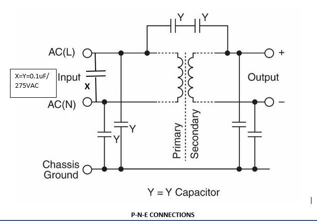

can we keep 0.1uF/275VAC in between Phase & Neutral, Phase & Earth , Neutral & Earth as X & Y Caps?
will this prevent the board from Shocks & Fire Hazards?

If we want to keep X-Cap then can we keep 0.1uF/275VAC? (I've attached pic below)

Submitted by PI-DATA on 06/15/2017
Hi Ish,
Regarding X and Ycap, they are only used to supress EMI noise. You don't need them as safety feature on your circuit. The are only called safety capacitors since they fail safe during component failure(For example, your X capacitor brokedown the safe failure would be an open capacitor. As oppose to normal capacitor which sometimes fail short which would be devastating if connected from Line to Neutral). For the reference design it only use one Ycap which is at 0.1uF/275Vac so there would be no problem.
