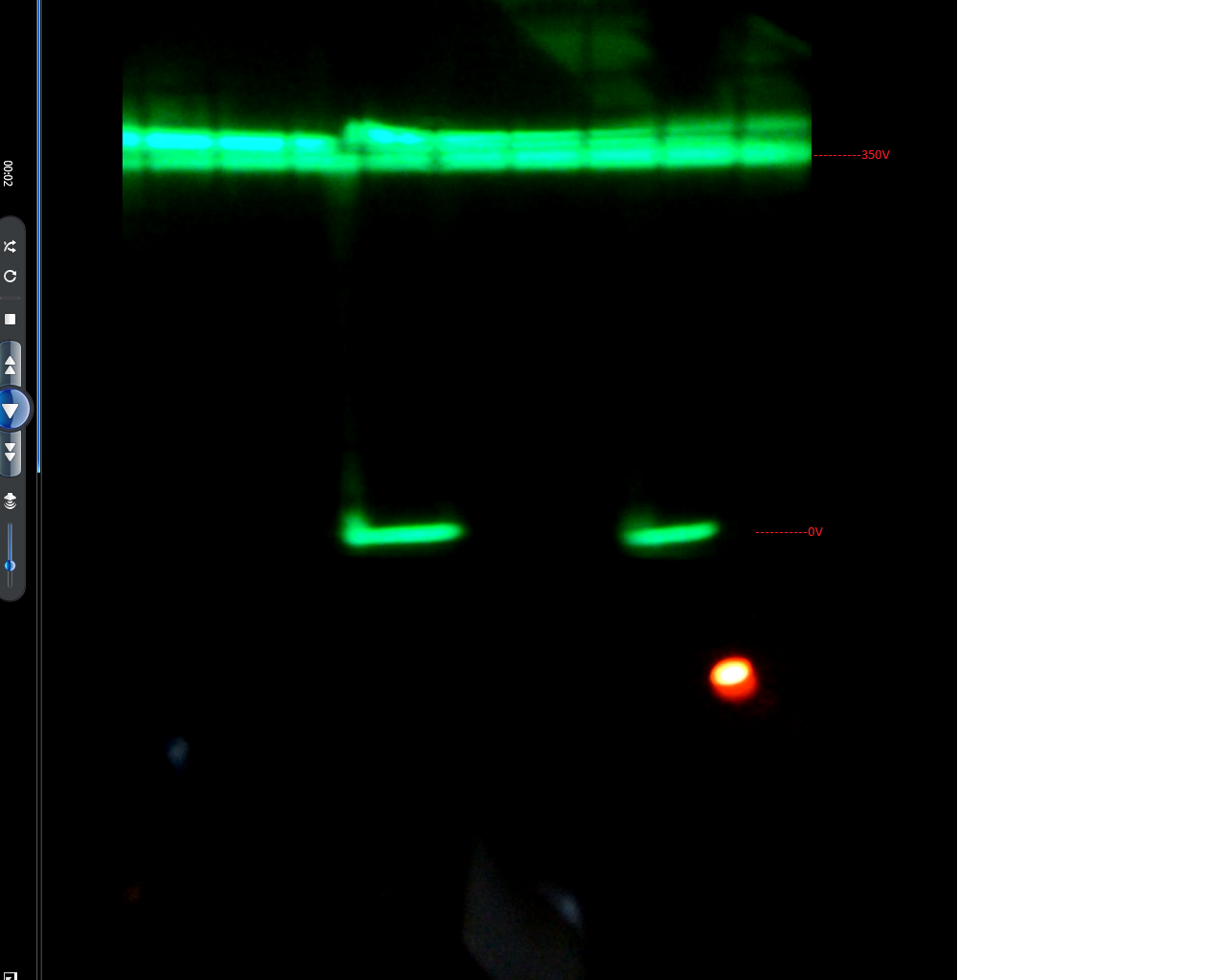

Submitted by raf329 on 11/18/2017
Hi,PiCard!
2 faulty boards works 10 days and again entered in auto-restar mode.
In attachment schem and screenshot the Drain waveform.
Oscilloscope mode scan time 2us. Please help to understand this issue.
I have not ferrite beam for 600V.
oscil Vd.png (333.02 KB) 333.02 KB
And in falling front Vd occurs before 0V???!!!!
In attachmentscreenshot the Drain waveform falling front.
oscil Vd fall.png (253.36 KB) 253.36 KB

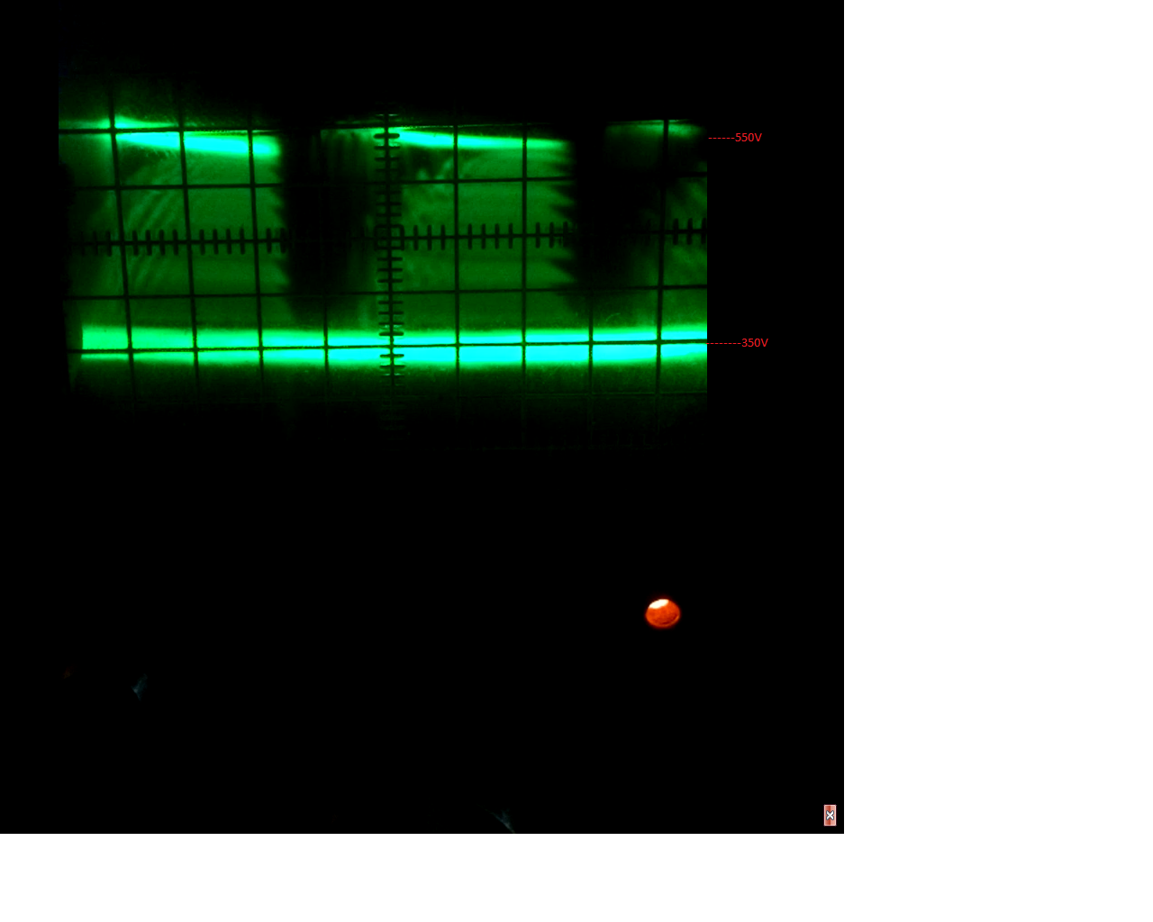

Hi,PiCard!
In attachment screenshot the Drain waveform working board.
Oscilloscope mode scan time 10us and 20us. Waveform Vdrain very difference.
