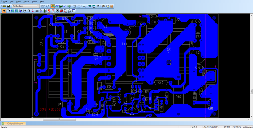

Submitted by signtronics on 07/18/2016
Yes sir, TOP IC blows up. I have tried different inductance values of primary winding to avoide transformer
saturation. I have also tried various turns ratios including the one which is given by PI Expert. I have also
tried removing external short circuit components. Still same happens. Please find attached PCB layout.
PCB Layout.png (100.4 KB) 100.4 KB
Submitted by PI-Neela on 07/19/2016
did you share with the PIXL file, that will help us to understand the design.
Submitted by PI-Neela on 07/27/2016
when I open your PIXL file, it is not readable. maybe you can convert it into PDF?
Please capture the primary waveform with lower Vac where you mentioned is not blow up, and around the boundary where blow up start to happen. Also monitor the wavefrom at the blow up event. That helps to dignose.
